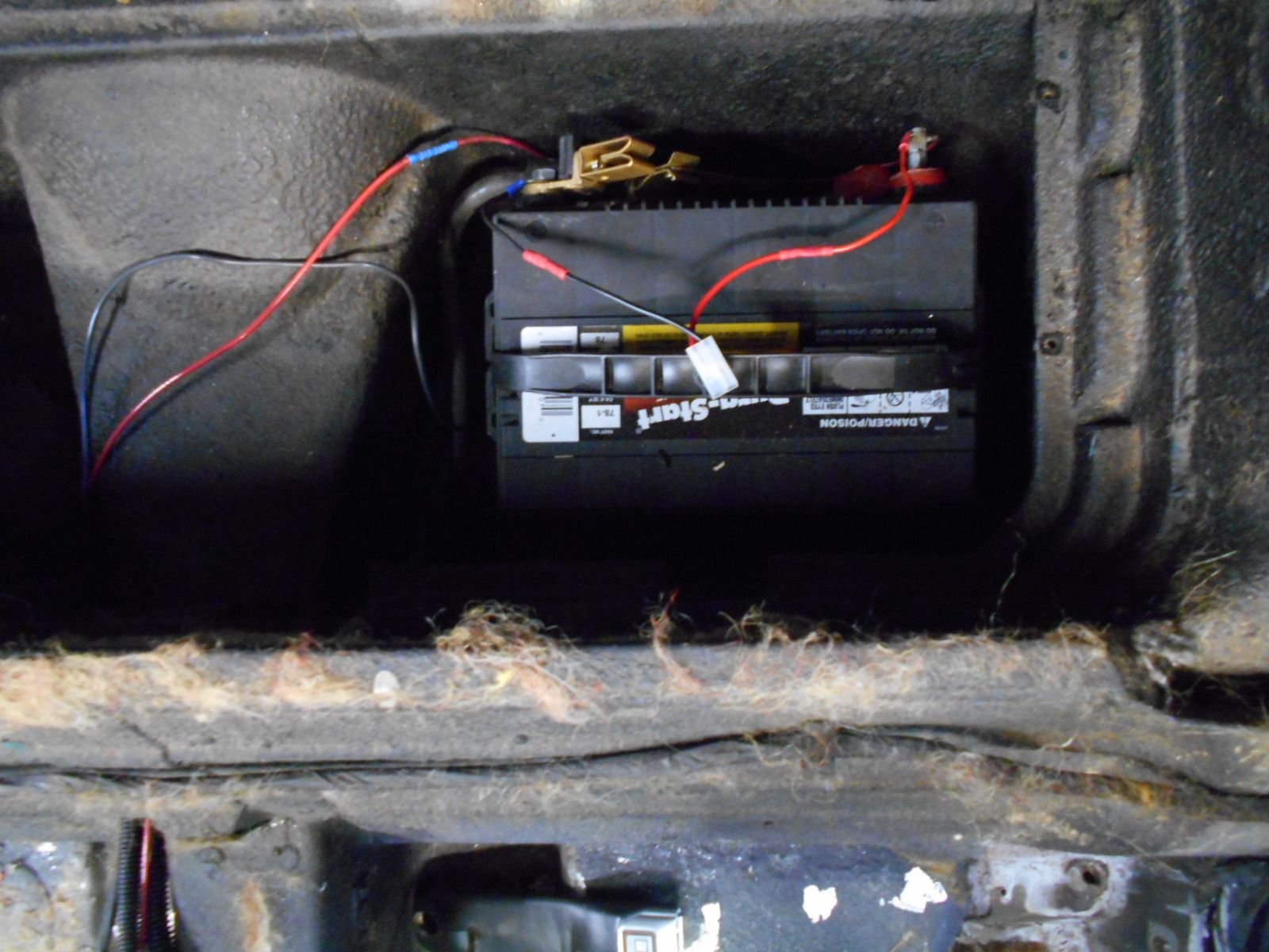

I have quick disconnect switches connected to the negative side....similar to the setup in the video that Richard454 posted. The disconnect switches I am using currently have the small bypass wire and fuse to provide a small amount of volts to the clock which is my primary reason for using the negative terminal quick disconnect.
I get why 7T1vette and KenSny would choose the positive terminal instead for their quick disconnect setup.

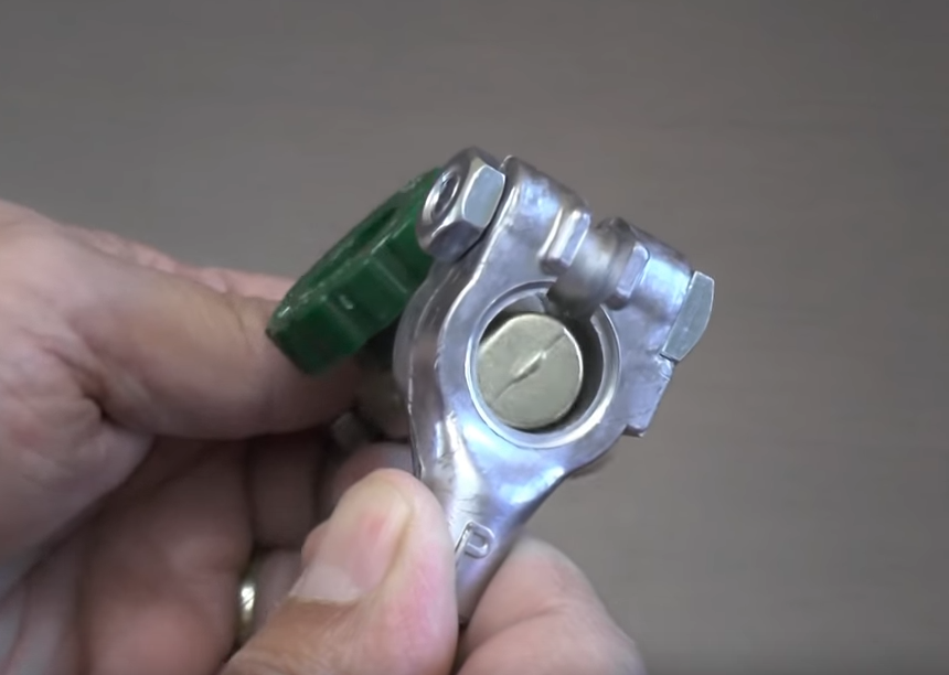

The post terminals on a battery are different sizes- the negative post is smaller than the positive.
Measure the the disconnect switch and you'll find it was designed to fit the negative terminal. Most have green or black *****.
Side post type will work on either - but it is still recommended to use the ground as your disconnect side.

NCRS 1968-1969 Technical Information Manual and Judging Guide, 5th Edition P. 47, "Fig. I 13.0 R59S battery with a cut-off switch attached to the negative cable" shows a photo similar to this of the disconnect...

I have used 'Green Switches' for years. As shown above.
The DEFECT in the green switch is that the weight and or the angle/pressure by the stiffness of the wire can OVERRIDE the disconnect. Causing the green switch to 'make' even though it's unscrewed.
I check this by looking at the dome light..... making sure that OFF is OFF!
Be careful of how you do this...

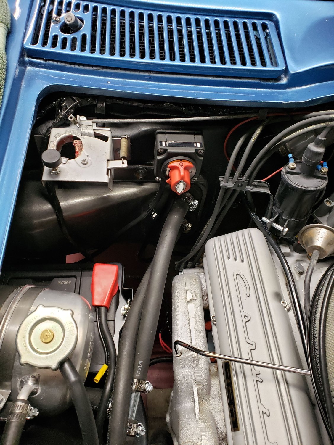

I've opted for this style now. Remote cable, clean switch and most importantly, no exposed bare metal.
