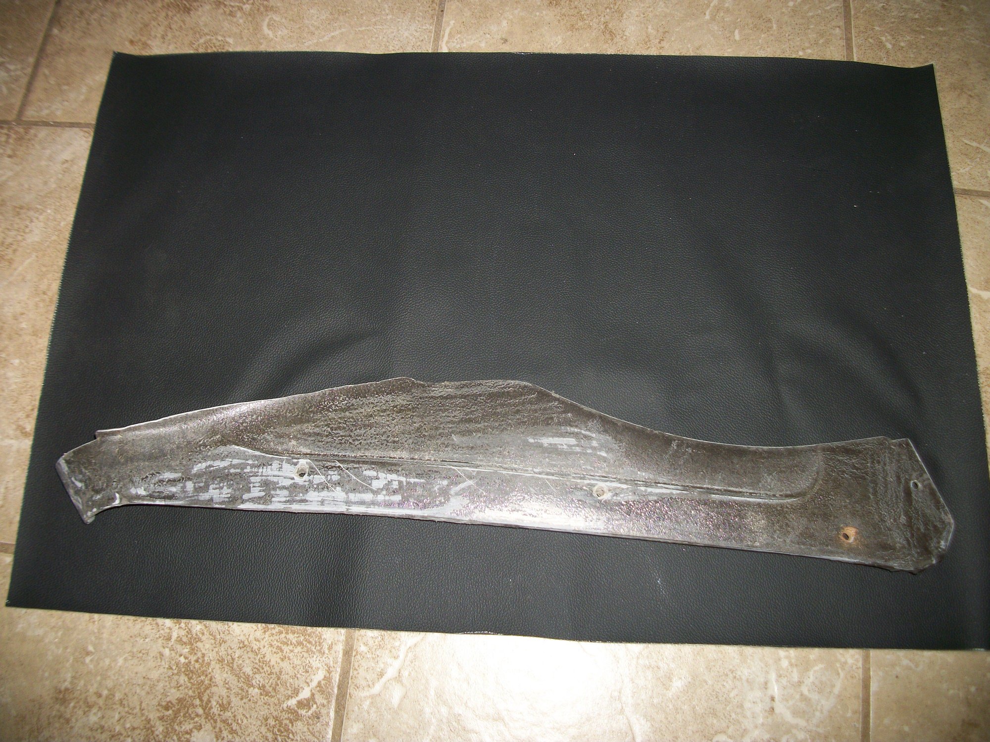

I. Just discovered similar rules apply when recovering fiberglass panels with upholstery glue....the leather-vinyl has to be preessed down onto the panel until it finally decides to adhere
