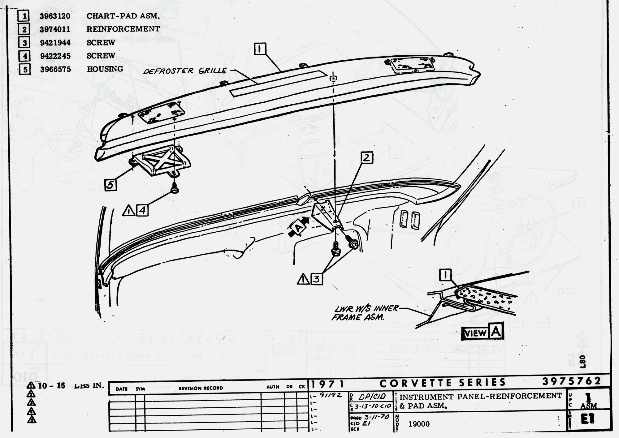

Old Feb 20, 2021 | 12:36 PM

ZAKsPOP, thanks! Haha feel silly now.
Took two seconds.....
To Dash pad removal?
