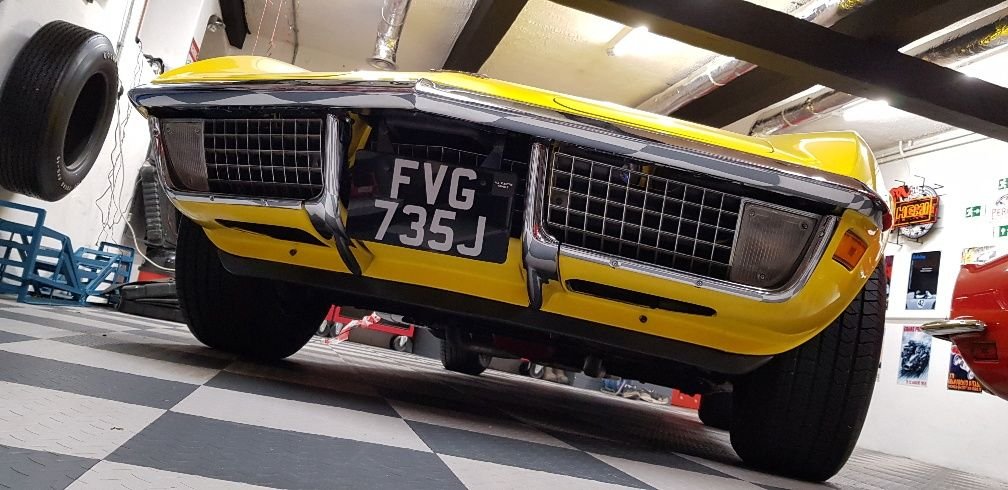

Hey Scott
I replaced mine a few years ago.. Believe I got it from Corvette America.. I think they are all the same. I had to drill one new hole in the spoiler (drivers side) to get holes to line up correctly on the fiberglass lip. No biggie. There is a slightly larger gap than the original one, but overall I am pleased with the outcome. (Shipping charge is more than the part!!!)
Here is a pic.
VS
Replacement spoiler

LOOKS GREAT "VERYSOON" ! Beautiful car, by the way!
I believe all of the vendors are sourcing from the same supplier, and fitment is hit and miss.
