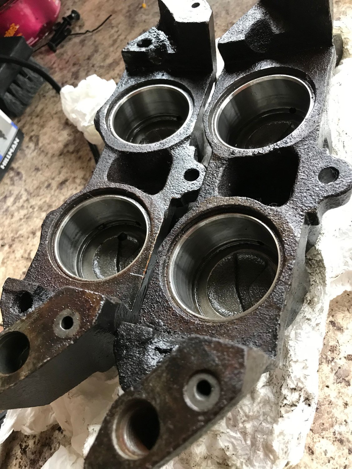

What do you have on your car now? Have you opened them up to see if they have been sleeved? Are they Delco Moraine castings? A few pictures would help. if the calipers have been already sleeved, you can buy an O-ring kit for about $150 and rebuild all four wheels. Jerry

it is a delco casting and has been SS resleeved, so all I need is a o-ring rebuild kit, it was a lip seal and it was leaking
