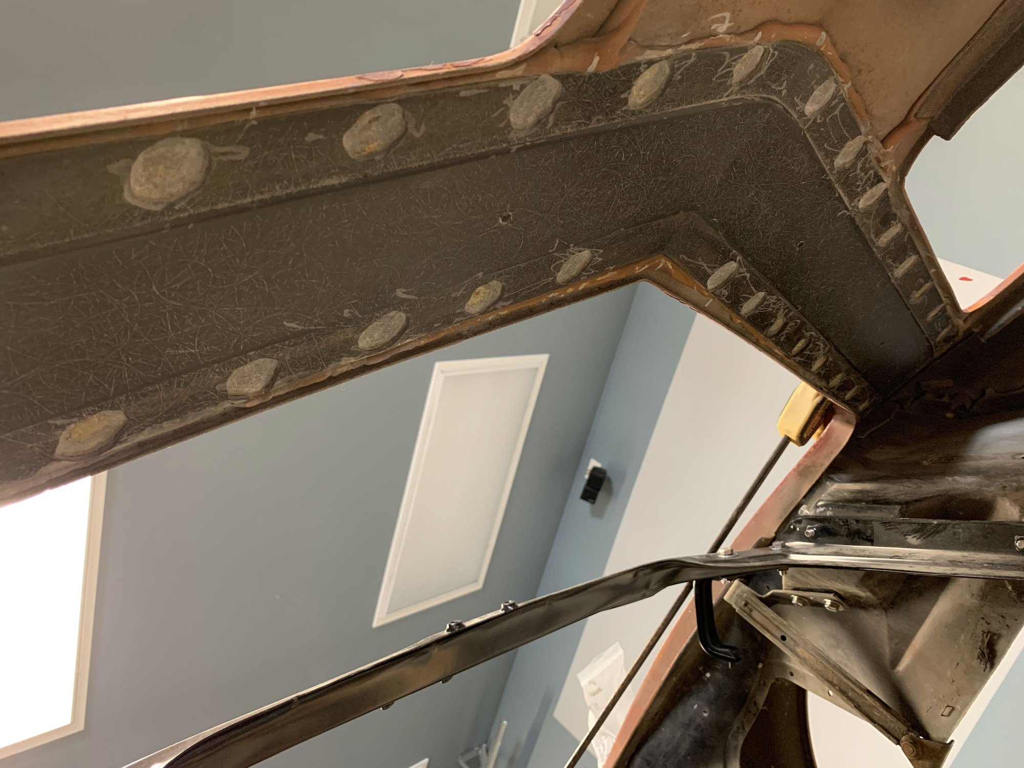

front, i do! Very easy to do with car already apart. underneath the front end ,grind off the rivets head. once all rivets heads are gone pry the support off with a thin putty knife and or hammer blows to its sides..

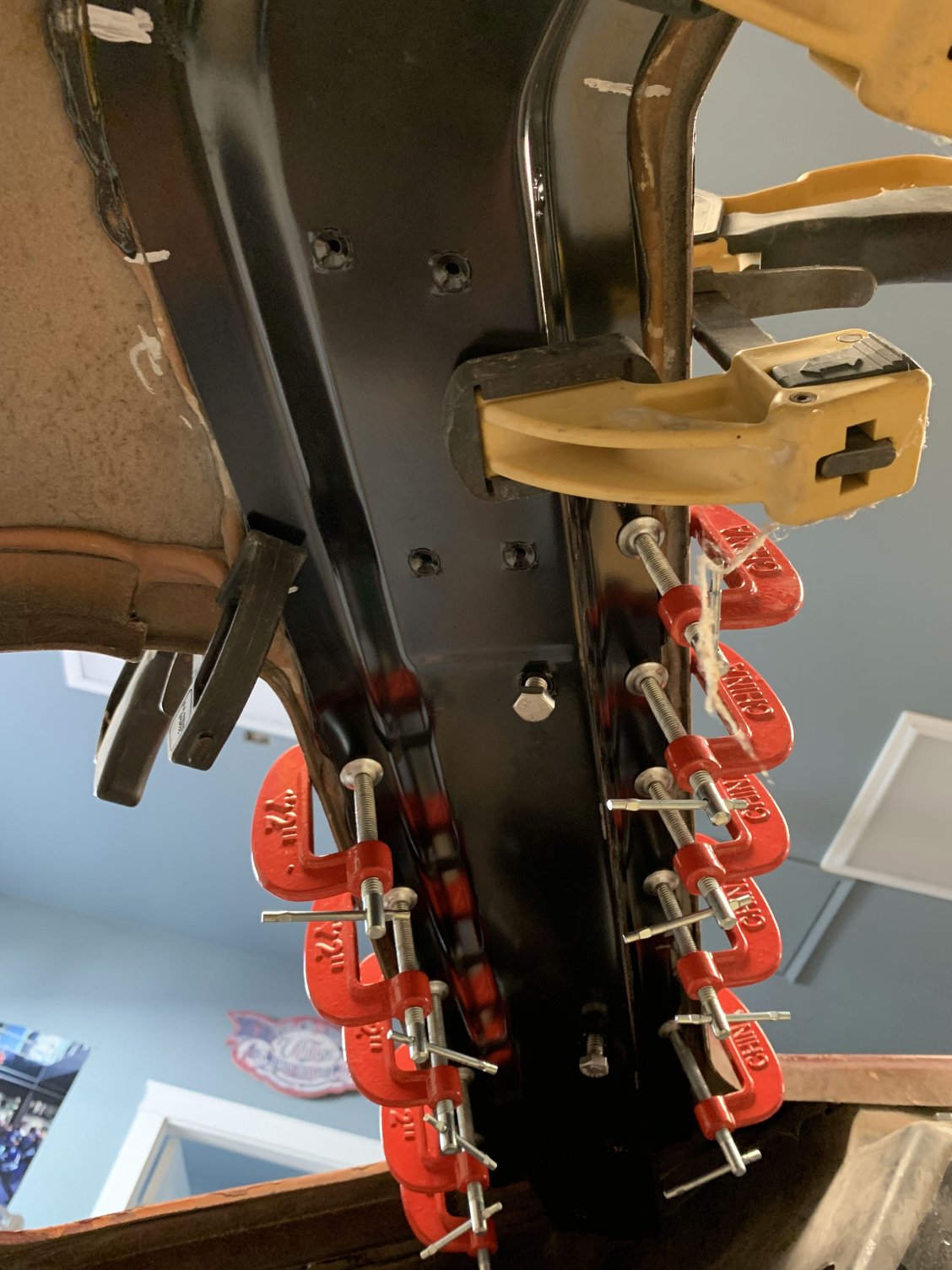

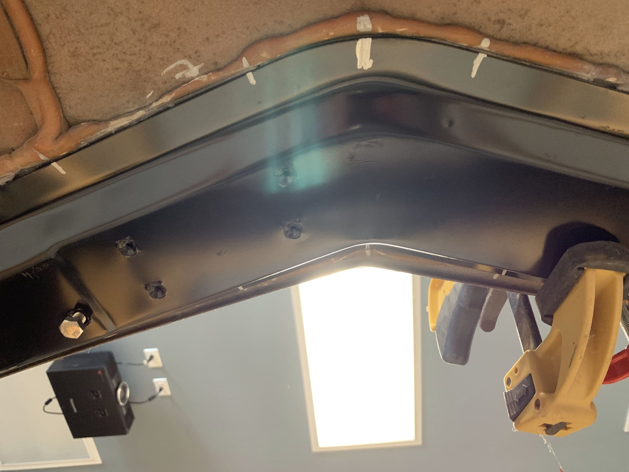

Same advice as the members above. I did mine during the frame off restoration with everything removed but if the headlights and grills are removed, you could do the same.
The Willcox “Installing headLamp Header Bar” document is really good and it is what I followed to replace my rusted out header bar. Thanks Willcox!
http://repairs.willcoxcorvette.com/w...stallation.pdf
I didn’t have to cut the header bar in pieces first or pry it to get it off. I just ground off the rivet tips with a zip cutter and ground deep enough into the old rusted header bar so that there was no rivet metal sticking out grabbing the header bar. The header bar just fell out.
I then used a Dremel and a flat end metal cutting bit to grind out the galvanic corroded rivet remnants from under the bonding strip. In order to get all of the aluminum rivet remnants removed, the holes became the size of a quarter and about a 1/8” to 1/4"deep.
DO NOT GO TOO DEEP TO GO THROUGH THE FIBERGLASS PANEL!
I mocked up the new header bar and marked a couple of locations for alignment then used SEM 39747 to adhere it using clamps.
Cheers,
Richard

Originally Posted by Kidster
.DO NOT GO TOO DEEP TO GO THROUGH THE FIBERGLASS PANEL!
YES! Do not penetrate the top layer. Dig rivets out from the bottom. And the bonding strip never moved, it remained in place, I just dug the rivet heads out of it. Only the metal header came off. With the boards, glue, & enough clamps, the "rivet bumps" should all flatten out for you pretty well. Best advice above was to look over the Willcox info first.

You do not want to remove the bonding strip. It’s not going anywhere and provides a good guide for the new header bar. Just make sure that you get all the old aluminum rivet chunks out so they don’t ever cause a problem again.
The adhesive gets sandwiched between the new header bar and the bonding strip and it squeezes out to the edges helping bond it. It leaves enough of a film between the two substrates to permanently hold the header bar in place but not enough that would cause the headlights to sit lower than the headlight adjustment range that the pivot adjustments can’t handle.

Here's the tool I made to remove the glass from underneath and get to the rivets.
Obviously a soft touch is required so it dont pop out the other side. I shortened this little hole saw cutter for the job. Its a Starret, No.A-4. Cut the bottom ring of teeth off, removed some length and then welded back on. Ground down the pilot and pulled it back so it didnt come in contact with anything while cutting. The teeth are 7/8 wide and total length is 2 1/4. After marking the headers position so it can be put back exactly in the same spot the tool simply removed enough material to remove the rivets.
Lord-Fusor adhesive in a double tube gun was used to put the header back in. Rock solid. I went Harbor Freight clamp crazy to hold it back on.
Clamping thin wooden slats on the paint side of the car over all the bumps made them vanish. I couldnt believe it, they were gone.

It’s pretty thick glass. It didn’t move much but always be careful when removing any reinforcement. I did the removal and install over a weekend so it didn’t sit vulnerable for long.
The repop header bar fit snug on the bonding strip with only a slight bit of side to side play. During the prefit and mark up, I installed the two side reinforcements that hold the header bar to each inner fender in order to mark it for perfect alignment.
Mine went in exactly where the old one came out. Everything lined up in the end.

If you look back at the picture I posted in reply #6, you`ll see that the hood is on, lined up, & tightened down.
The header bar was bonded on AFTER the hood was lined up. The clamps fit between the hood & front edge of hood opening.
