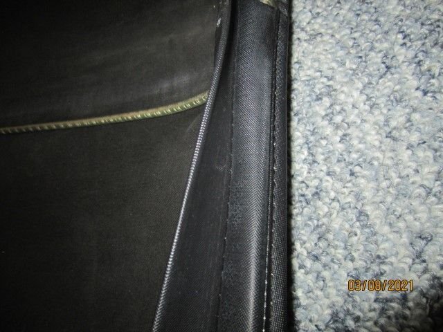

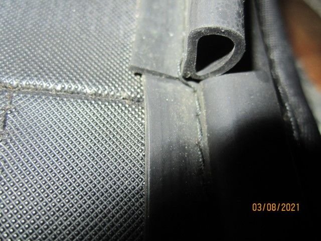

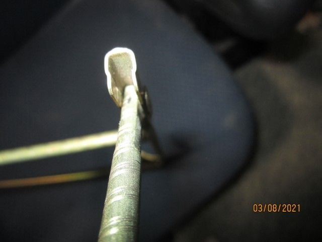

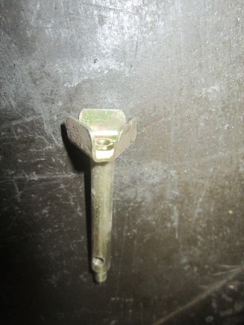

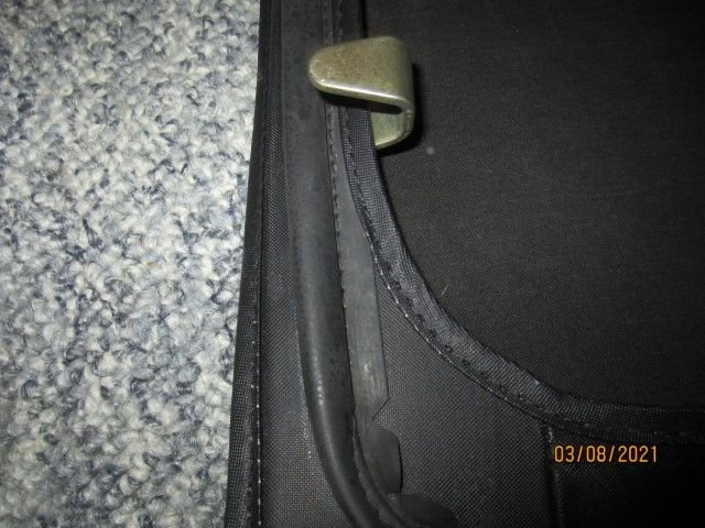

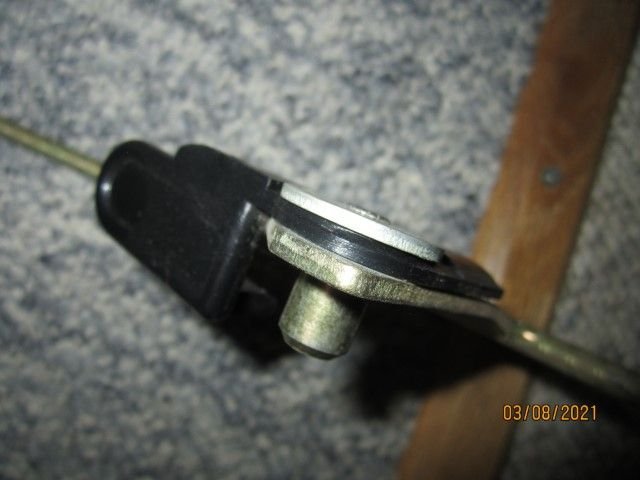

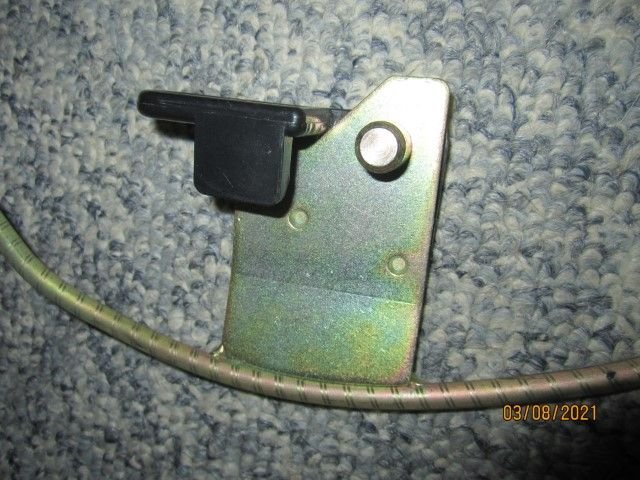

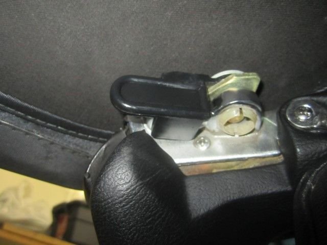

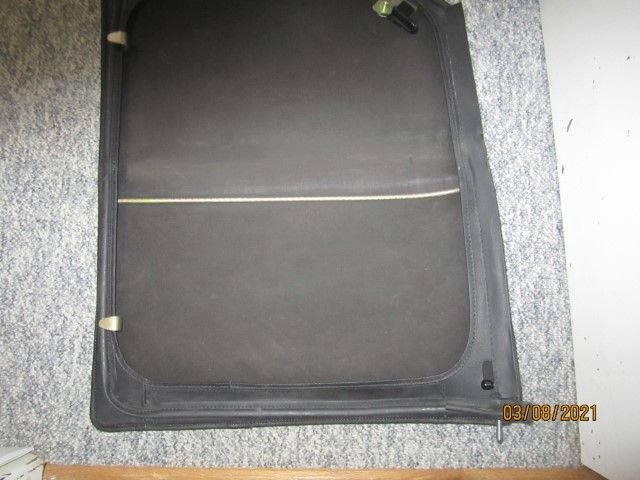

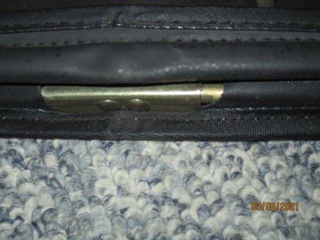

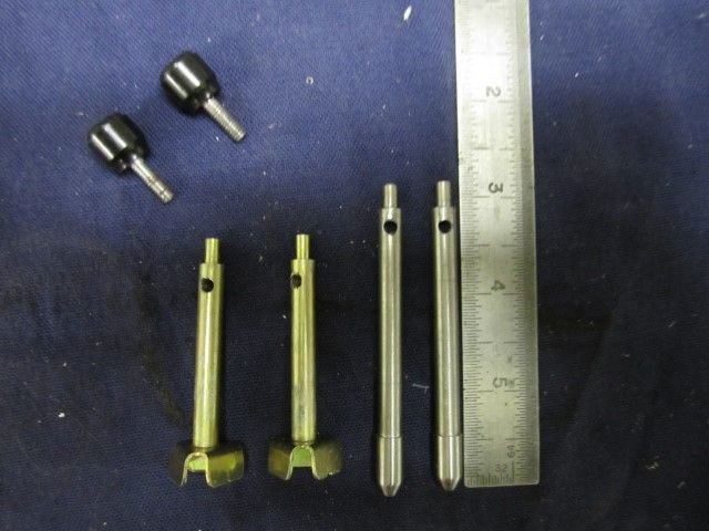

Here's some pics of how the details are. the frame is pretty much all 1/4" rod
Frame hooks to center bar, bent from 1/8 thick bar, 3/4 wide
Front outer clamp that goes into the hole with the plastic insert pin goes. The black plastic piece swings around and goes under the chrome part on the windshield trapping the pin in place. The two round indents on the metal plate act as sort of stops holding the black part open or closed as it is turned
rear connection was available in either the early 2 latch triangle or later single latch bullet (mine has the bullet)
The **** unscrews and you can swap the insert
Older triangle one ( I gave mine to CraigH)
Hinges
made so when open they spring around the frame rod and hold it tightly open/straight
The fabric is convertible top material, the weatherstrip is in long strip form that is sewn into shape with a loop out near the rear-outer edge
No rubber strip at the window but there is a 1" or so flap that hang down outside the window (I believe to keep rain out rather than running in)
Frame is held into the pocket around the inside edge of the fabric with vecro strips, all the way across the front and two pieces at the rear
There's a fair amount of work in them
Hope it helps
M
