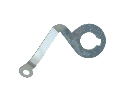

Do you have the headlight switch ground strap on?

Actually I don't I have entire dash apart and just have the plugin. didnt think of the ground.
