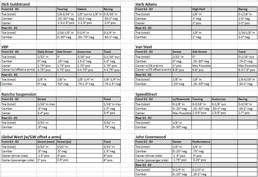

Old Mar 12, 2021 | 12:01 AM
White 68's Avatar
White 68
Joined: Dec 2001
Posts: 1,560
Likes: 5
From: Dallas Texas
Some reference numbers for your shop !
