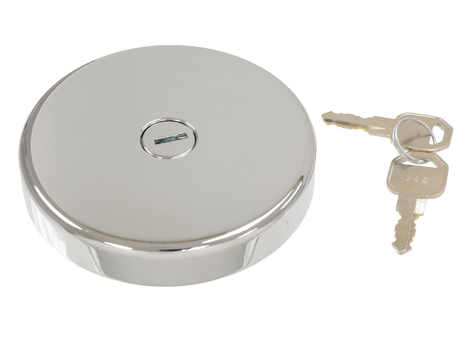

The filler neck is attached to the top of the tank with 9 hex head bolts. If you pull the rubber filler boot out, you might be able the unbolt the neck from the tank. If the cap is one of the flat round chrome ones, with the key hole in the middle, once you get the filler neck out, you should probably be able the get the cap off by disassembling it. There are three Phillips head screws on the underside of the flat chrome caps, that hold them together. If you can't get it apart, with the neck off the car, you can drill out the lock without worrying about getting something in the tank. With the cap on, you may have to tear the boot to get it off, but new ones are less than $25.

A 1971 would be a metal locking cap it would look like this.
A trick locksmiths use is you get a set of new uncut keys that fit the lock. Then file the key edges to a knife edge insert the key and using some force turning it. Then remove the key see were the tumbler pins make an indentation and file to make the keys teeth. Will take several times to inserting the key and filing to get it to unlock

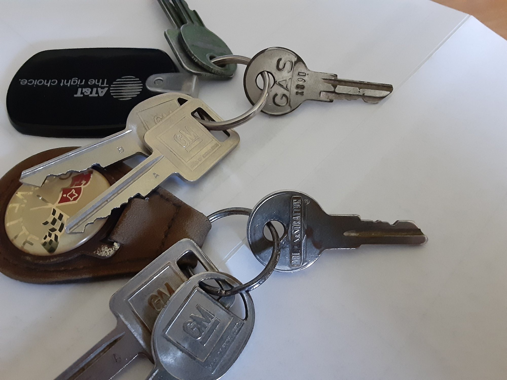

The chrome locking gas cap on my '71 looks like that, but it's 50 years old and the key has Briggs&Stratton on one side of the key and # (A890) on the other side.

Those were a dealer installed option and the Briggs key is correct. They sell for about $50-$75 if in nice shape with B&S keys. I had one on my 72 when I bought the car back in '79, never knew about the dime trick either but sold it at Carlisle the year people were walking the car field stealing c2 gas caps. I had mine on my table the year before with no takers, that year 10 guys came back after lunch looking since the crooks hit them in the morning.

Green 454; that is the key and the cap! Thanks!
