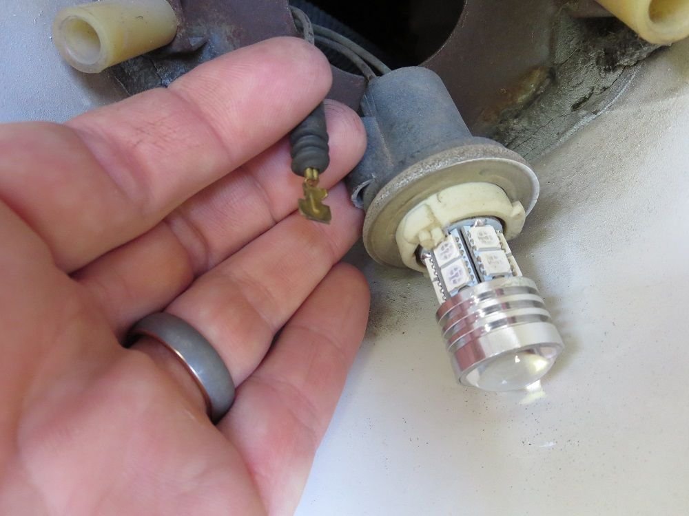

Hey all, got a question for the wizards out there on my 81...
i changed the exterior bulbs to LED bulbs (i like the look so no hate) and everything works wonderfully except the passenger side turn signal.
When no marker lights are on, it flashes normally when turning right and the hazards work fine. Put the parking lights on and it only goes into the bright mode but doesn't flash.
The dash indicator is blinking normally but the front and rear bulbs don't flash.
hazards don't flash either with lights on
The drivers side works perfectly with no lights and lights on.
Whats been done:
- changed both front turn signal sockets soldered and heat shrunk tubing the connection.
- checked and wiring is done the same on both sockets.
- swapped bulbs from driver and passenger side knowing 1 bulb is good - same outcome
- checked with a test light to make sure sockets weren't the issue. Both sockets/wiring is acting the same and its showing that its “flashing” on the test light. Marker light and flasher are the same on both sockets.
- put a normal filament bulb in pass side socket and it works normally
- installed LED compatible electronic flasher for turn signals
Ive heard that the hazards are on a separate flasher and that relay has not been changed to an electronic flasher. Where is that relay? Is it the round one similar to the turn signal on high up on the firewall fuse panel??
what would cause that one side to not work???
thanks in advance

usually a corroded ground wire to the frame causes weird signal issues. The LED light may be compounding the problem since the passenger side signal works correctly with the higher amperage filament bulb.
Or...a marker light wire is shorting against a turn signal wire.

I'll only put this out as some info, perhaps nothing to do with your situation and I haven't looked at the 81 turn signal wiring method
GM used a strange method of dealing with the turn signals with and without the park lights on, The power is sort of grounded when the lights are on and the LED doesn't let it try to go backwards as the regular bulb does. The "good" bulbs seem to handle it fine while some of the cheaper ones don't have the circuitry to allow it to work the way GM intended (which wasn't the way LED are supposed to work)
If it works with regular 1157 bulbs in the front and LED on the sides, then this could be related to your issue

I think what Mooser suggested is the most likely solution. The way the lights are installed on these cars requires current to flow in both directions at the front turn signal. See if the standard bulb fixes the problem. If you really like the look of LEDs (I have them in my cars, everywhere except the front turn signal), @Richard454 posted a quick fix solution module that addresses this problem. I'll add the link if I can find it.
The other possibilities:
You likely already did this, but just to confirm, you need a 3-wire LED flasher in both positions, turn signal and hazards. The unit that comes with the swappable base makes debugging easier.
Internal disconnect in one of your sockets (never trust old parts, and never trust new parts). This connector had failed, but not completely, so my turn signals would sometimes work.

Bikespace - ok, i have a 3 wire in the turns but not the hazard. Mostly because the hazards are working fine. Ill have to order another one though to take the relays out of it and any potential bugs.
Because 1 side works and the other doesn't just messes with my mind when it comes to troubleshooting.
also, i will take a look at the connectors inside the socket and see if i can't make the connection better and see if it helps.
The sockets are from the same place, wired the same and the bulbs are from the same place and when the leds are swapped (funky socket to known good socket) that bulb works. As you guys throw info at me, it is sounding more and more like a ground/wiring issue on that side. Just gunna take me a little to find it all.

I had the same problem with my '75, no LEDS in the dash but in all 4 turn signals.
I removed the front LEDS and all is well.
I'm more worried about being rear ended than if my front turn signals are brighter.
