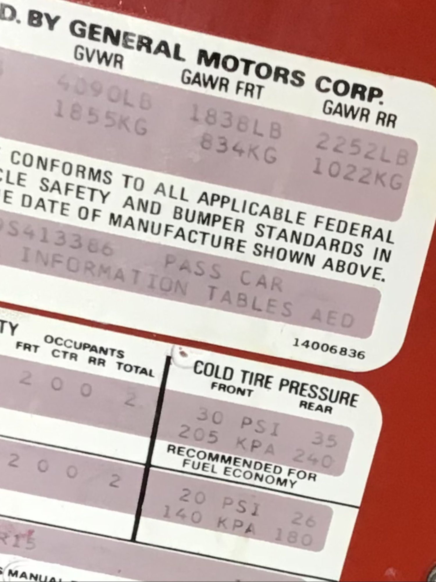

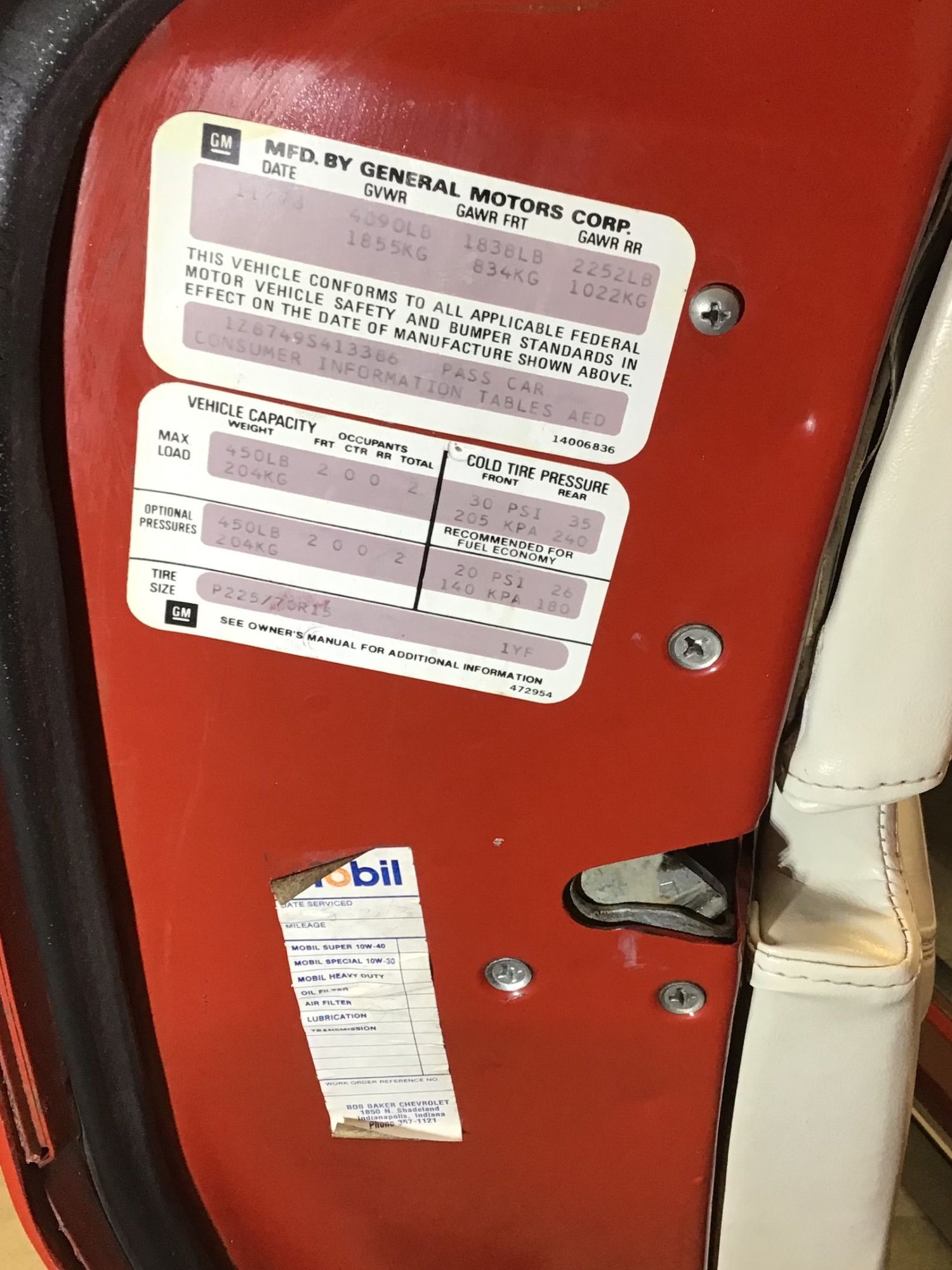

Not sure what stock tires you have but for 225s, the door label shows:
Front / Rear
30 PSI 35- Max
20 PSI 26- Economy. Which seems kinda low.
So if you are running say 30 PSI front and rear that translates to roughly 2.10 BAR
Tyre Pressure Measurement Converter
BAR --- PSI
2.10 bar 30 psi
2.15 bar 31 psi
2.20 bar 32 psi
2.25 bar 33 psi
Front / Rear
30 PSI 35- Max
BAR --- PSI
2.10 bar 30 psi
2.15 bar 31 psi
2.20 bar 32 psi
2.25 bar 33 psi
i think economy is the higher pressure
