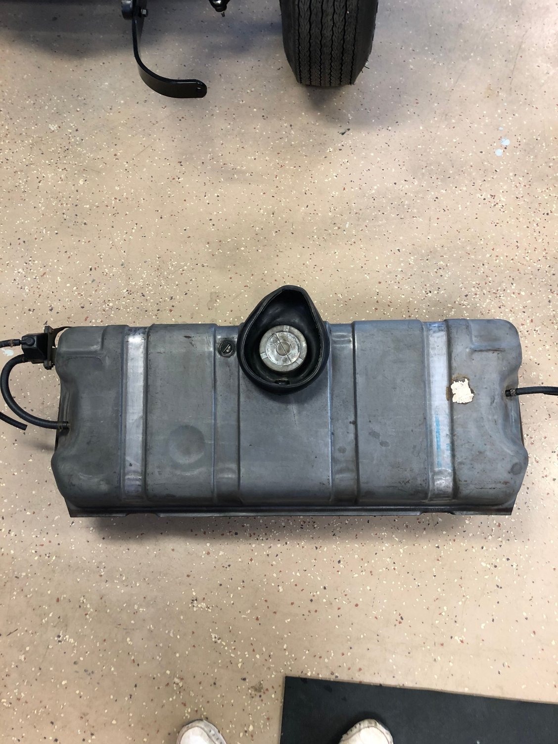

I removed my tank and was able to take it down with out moving the mufflers. I just needed to bring it down on an angle. It would be a good time to change all the hoses and the gasket for the filler neck.
My filler neck was leaking all over the top of the tank.
