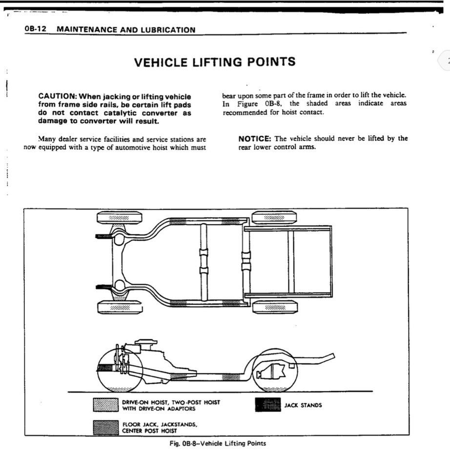

Old Mar 25, 2021 | 04:31 PM
interpon's Avatar
interpon
Joined: Jun 2019
Posts: 7,649
Likes: 2,466
From: Indiana
good video but OMG the jack placement scared the hell out of me!!!!
