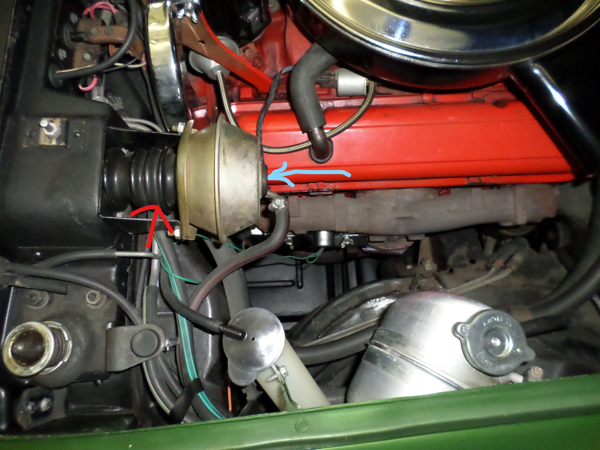

Do you have the double pie pan or the coffee can design. On the pie pan carefully remove the black rubber front plug. Once removed you can use a pencil erase end or some like that. Make sure you are dead center you should be able to push the door open. If you have a hand vacuum pump connect it to the rear hoses connection (green) that will for sure open the door.

Can you post a picture . I will order an AIM manual. Thanks

linkage

The older coffee can has the same plug type arrangement . Also ,if the rubber plug is original it can be so hard that its almost impossible to get out without damaging it .

Got it Thanks. My next question. another new post.
