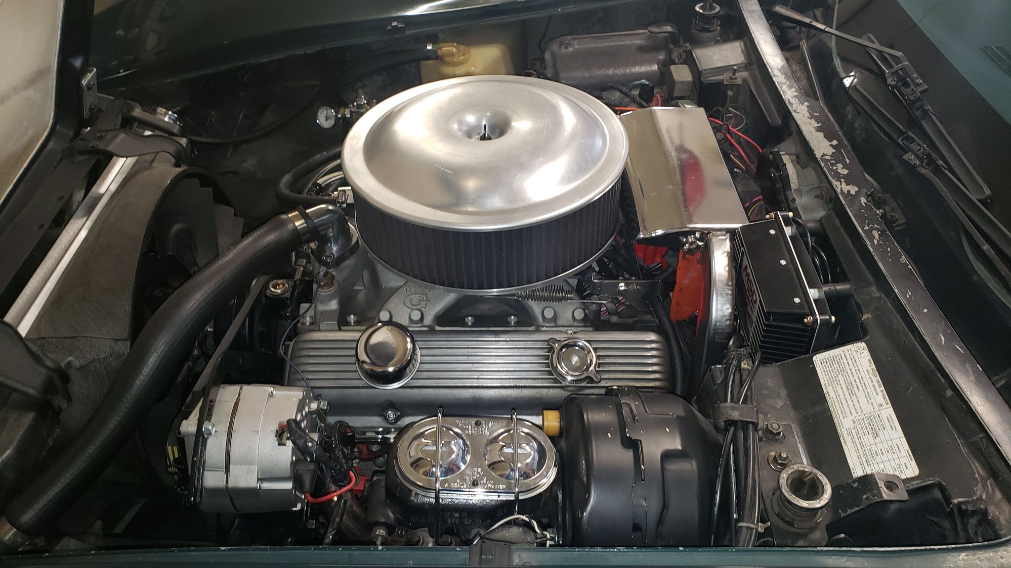

Unless I'm dealing with a totally original car, I get rid of all that junk. Smog pump, lines, egr, heat risers, everything. I run simple push in breathers.

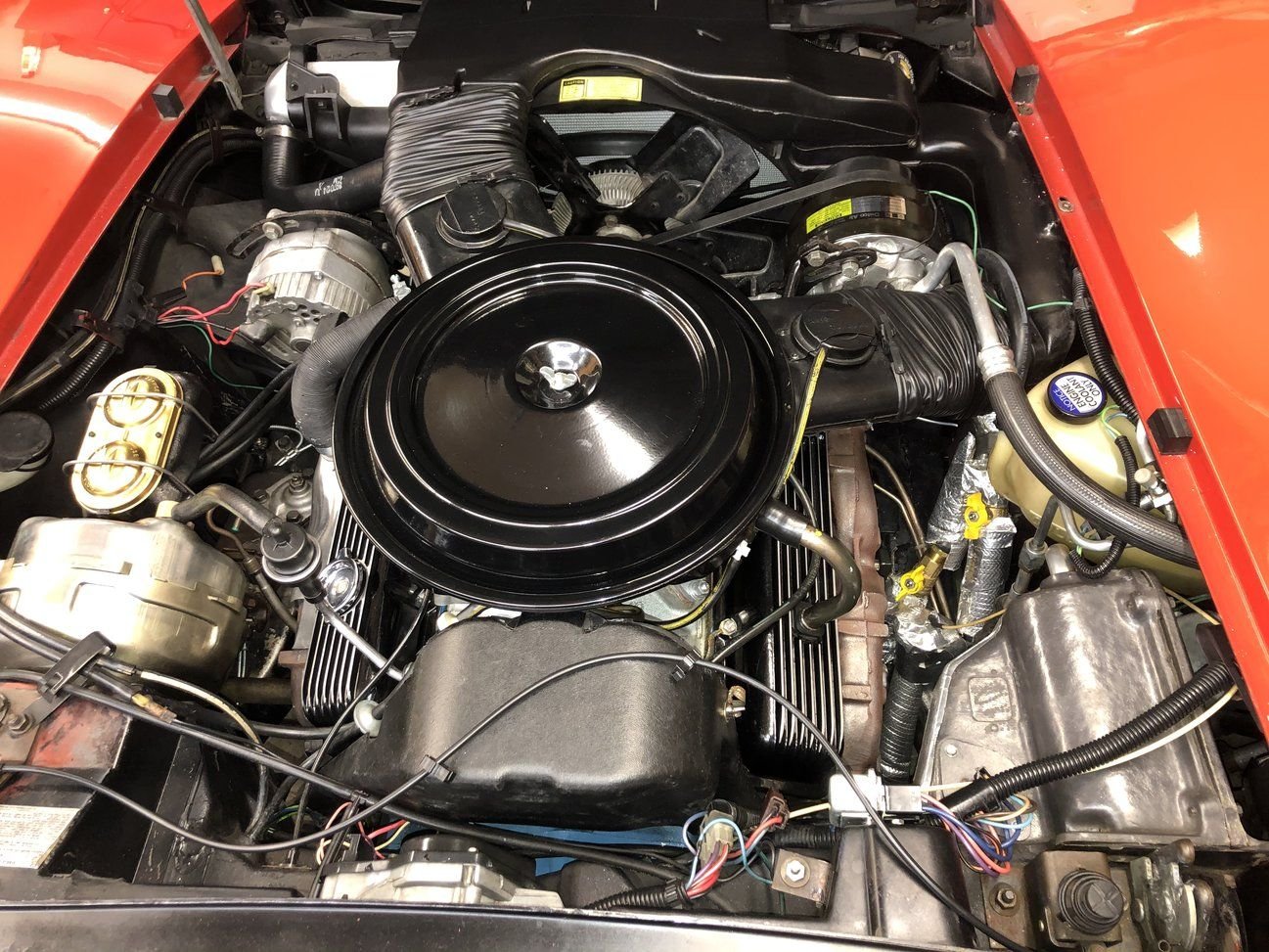

i disagree with the high speed only.. check this out..
Cold air cleaner Thermocouple experiments 79 L82 4m ac - CorvetteForum - Chevrolet Corvette Forum Discussion
i also use preheat as i drive in cold as well and it does an excellent job of heating air for winter.. and regulates. I know Bike leaves his open..i choose to leave operational..

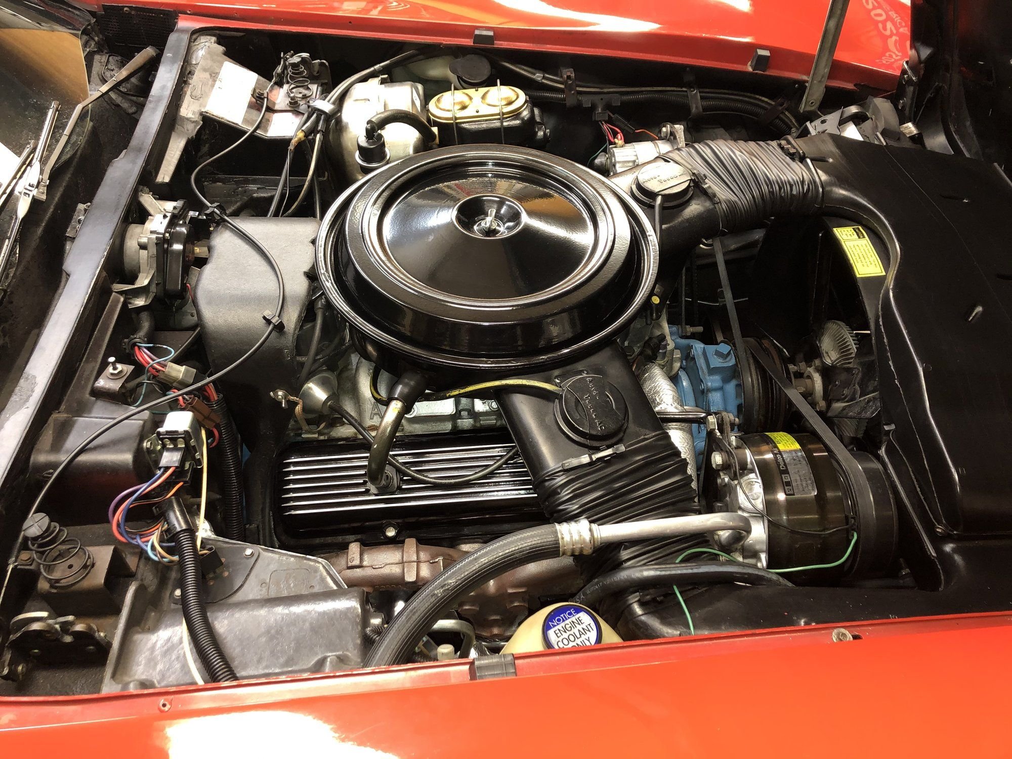

also some new car 79 as from factory if helpful

WOW, love the cleanliness of your engine area! I truly believe it should be taken care of under the hood just like outside of the car! This advice issue is getting too deep in the weeds. My only question was if I should keep all intake hoses and emissions tubing connected in order to keep things like they should be. I don’t take my car to the track, hell I barely drive it. I’m not a motor head and I don’t make any mods to the car, I just wanted simple advice, nothing more. I do appreciate all the pictures and diagrams as they help immensely. 😊😊

haha not mine this was 6 miles new off internet..

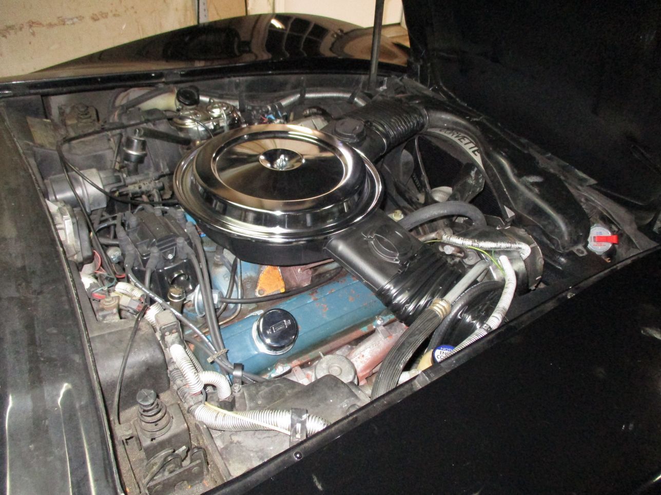

here is mine without emissions..

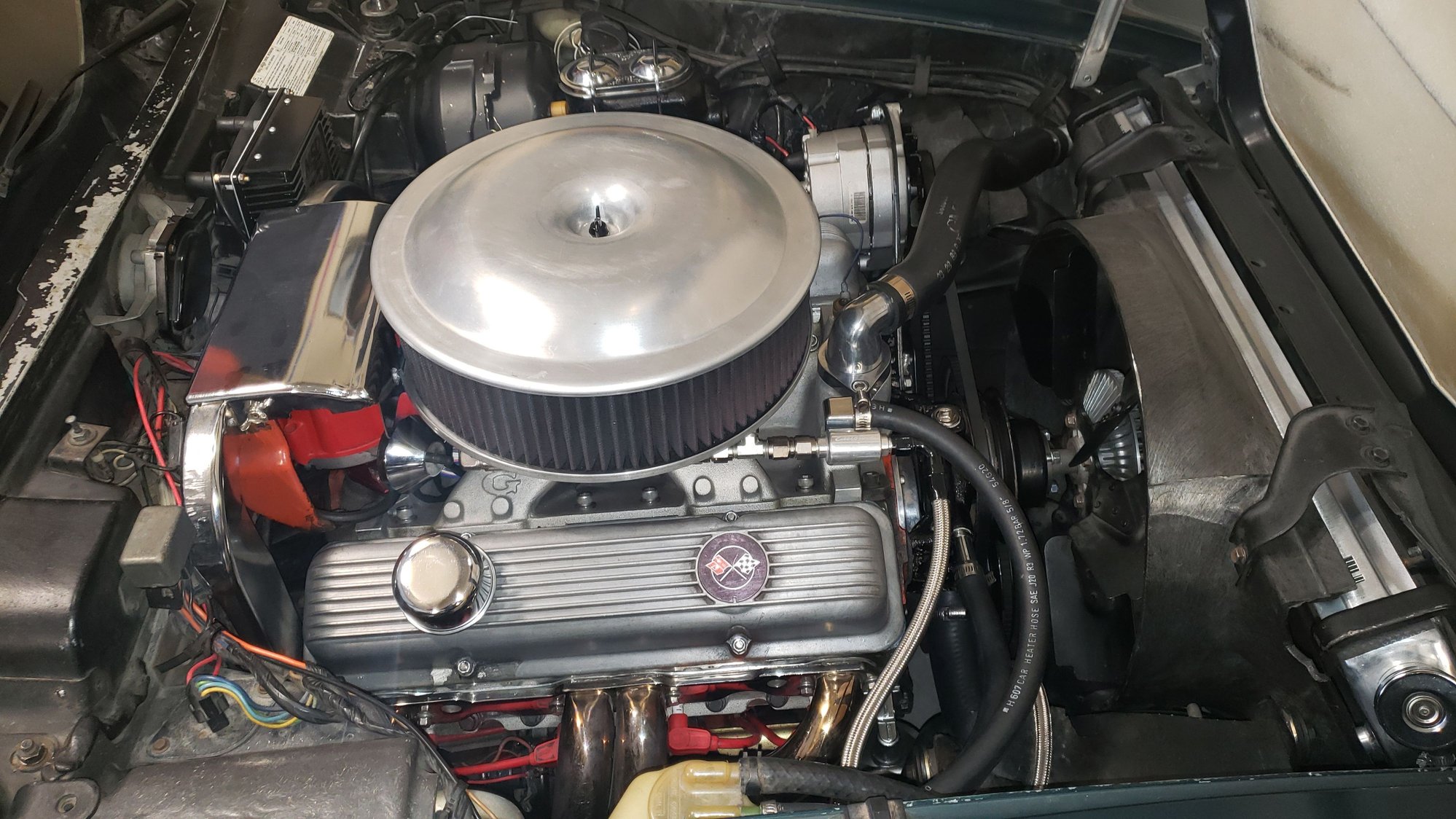

Are you looking for something like this? Go back and read post #2. You don't need all that smog ****.
