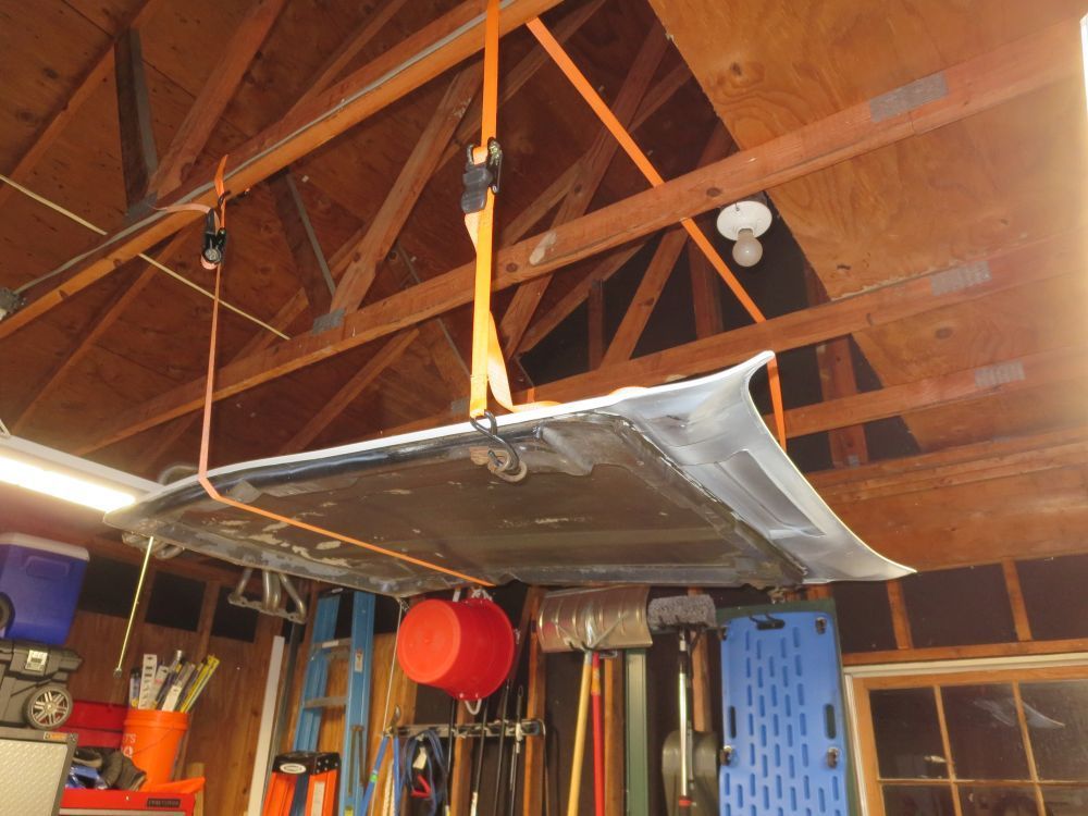

I'm glad it worked out. Please consider posting some photos to help the next 10 people with the same question, but who don't post on the Forum.
BTW, ,you can remove the hood without a helper. The risk is great, though. I'd make better use of pulleys next time.

Good job with the hood!
I thought of doing something like that, but when I start thinking of helpers like that, I end up getting nothing done.
