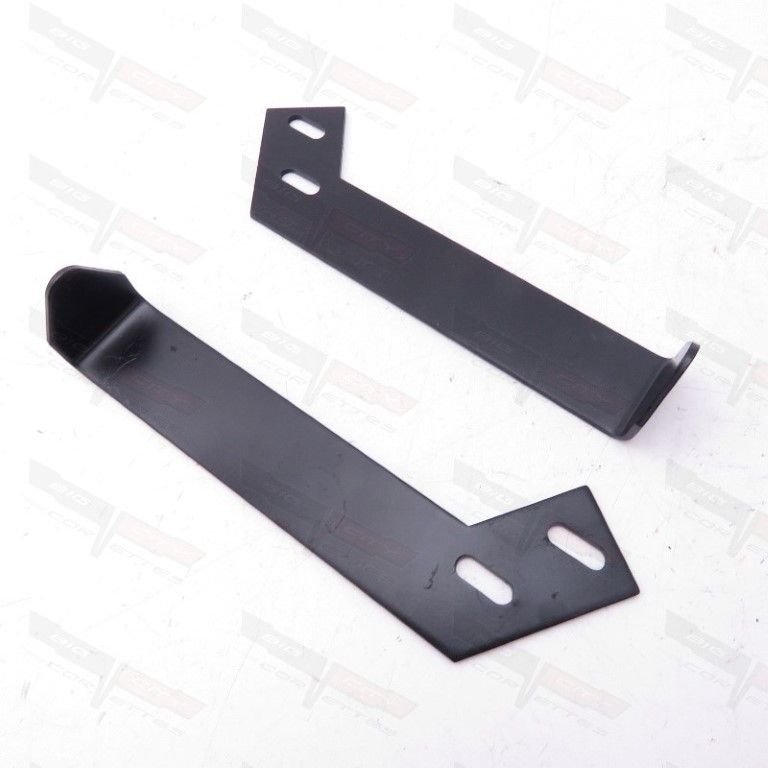

The clunk could just be the rest of the mechanism, there's a lot of stuff moving
M
The earlier ones had a stop bolt at the bottom, yours should have slots at the top/side to adjust but anyway, check that the bottom part if firmly touching the frame when it is up. I don't know if yours would have a cushion where it hits or not
