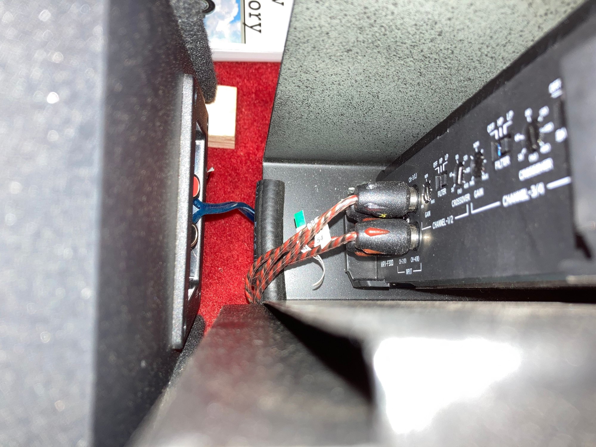

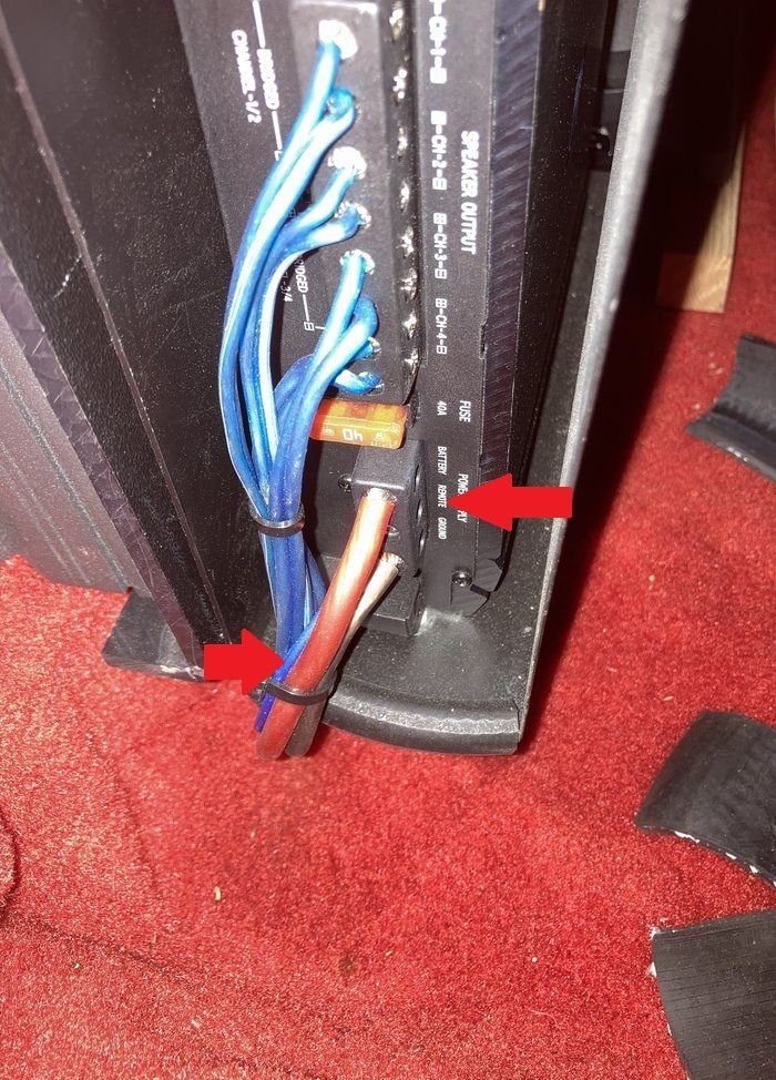

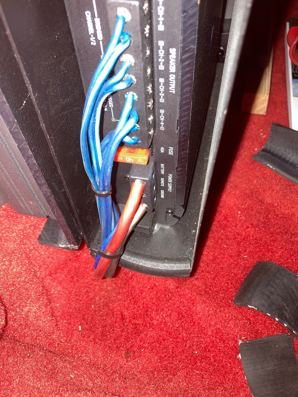

I checked out the amp but found that there are four blue wires with white stripes connected to it. I attached pics of both sides of the amp.
I realized when I was looking at the "new" amp that there's a second original amp in the system. I think it might power the subwoofer.
Can you recommend what I should be looking for next?
Thanks
Ken
The blue wires are labeled speaker output, the very bottom wire is labeled ground and the large round red wire is labeled battery
This is the opposite side of the amp and those four wires are labeled input

Hey ken-
Look at the smaller gauge blue wire zip tied the the red/black power wires (see pic)
Connected to "remote" input.
When that wire has +12V - the amplifier will turn on. I'd disconnect that wire-make sure it doesn't short out-
Then see if you still get a sound out of the speakers when connecting the charger.
If that's the case- that wire is incorrectly wired to a constant on source- and you have to trace it at the radio and see whats up.
