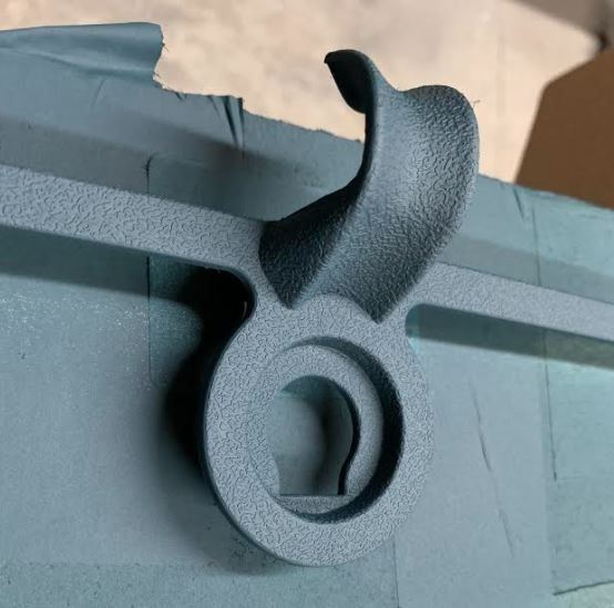

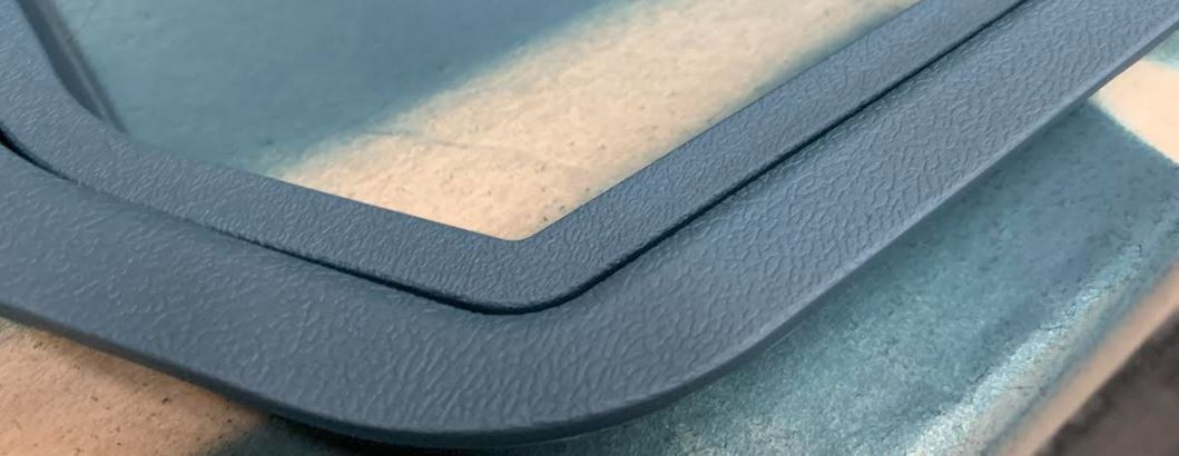

Here are a few pictures of how the new trim surrounds turned out with the Corvette America Dark Blue Dye with no clear coat. I have not tried to dye any of the original trim pieces as I will try to see if cleaning them really well will make them all look new again.
This is the same as how mine turned out after painting with CA's dark blue paint, if it makes you feel any better. I ordered the SEM semi gloss clear spray. It gets here Thursday. I'll let you know how it comes out when I get done.
