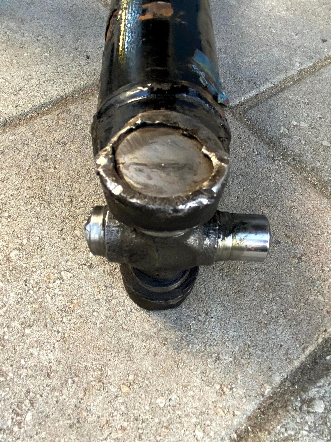

My driver side half shaft does not have any dent or crack but the C-clip grooves are badly scraped (as it is seen in theses pictures). Do you recommend keeping this half shaft and just install new set of Spicer u-join or I must replace it?

That yoke is pretty chewed up, you can find GM shafts in better shape for about $30 - I would replace it.

thanks for the hint. I just bought a used (very good shape) half shaft for $30 (your price estimate was right on). will pair it with Spicer (5-1350x) u-joint and put it back together
