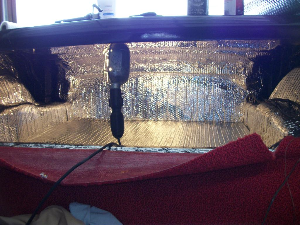

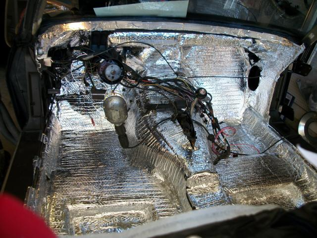

HVAC wrap and heavy-duty HVAC aluminized tape to hold everything in place.
It reflects interior heat like you would not believe...as a bonus it absorbs noise too.....

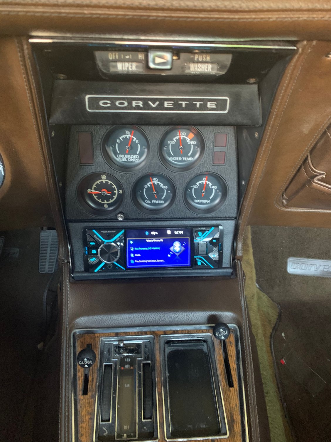

This won’t be to everyone’s taste, but I had a stereo put in today, along with a backup camera. Down the road, I might go with a better stereo, but it’s nice to stream and make hands-free calls. My previous aftermarket radio from Custom Autosound quit working, whether because it got wet in the storm or just died after 30 years. I have the original radio and bezel tucked away in case I ever really want to go back to stock, but that’s unlikely.

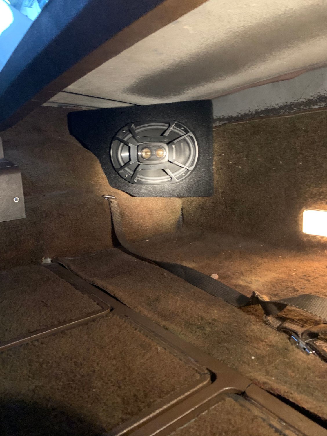

Catching up a little more documenting my build...added in new rear speakers to go with the new stereo. Two Polk 6x9s really upgrade the sound. I went with the cutout boxes rather than the soundbar. The boxes were easy to install to the car, two holes drilled and two screws each, but putting the speakers in afterward was a PITA since I only have two hands. It might have been easier if I'd ordered the pre-installed speakers; the screw holes in the boxes didn't match up with the holes in the boxes, so I had to drill some new ones, which I think made it even harder when reinstalling them in the car.
