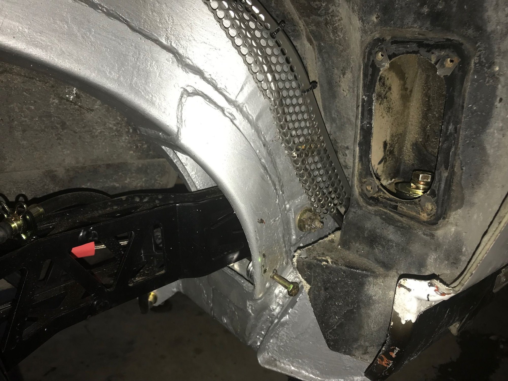

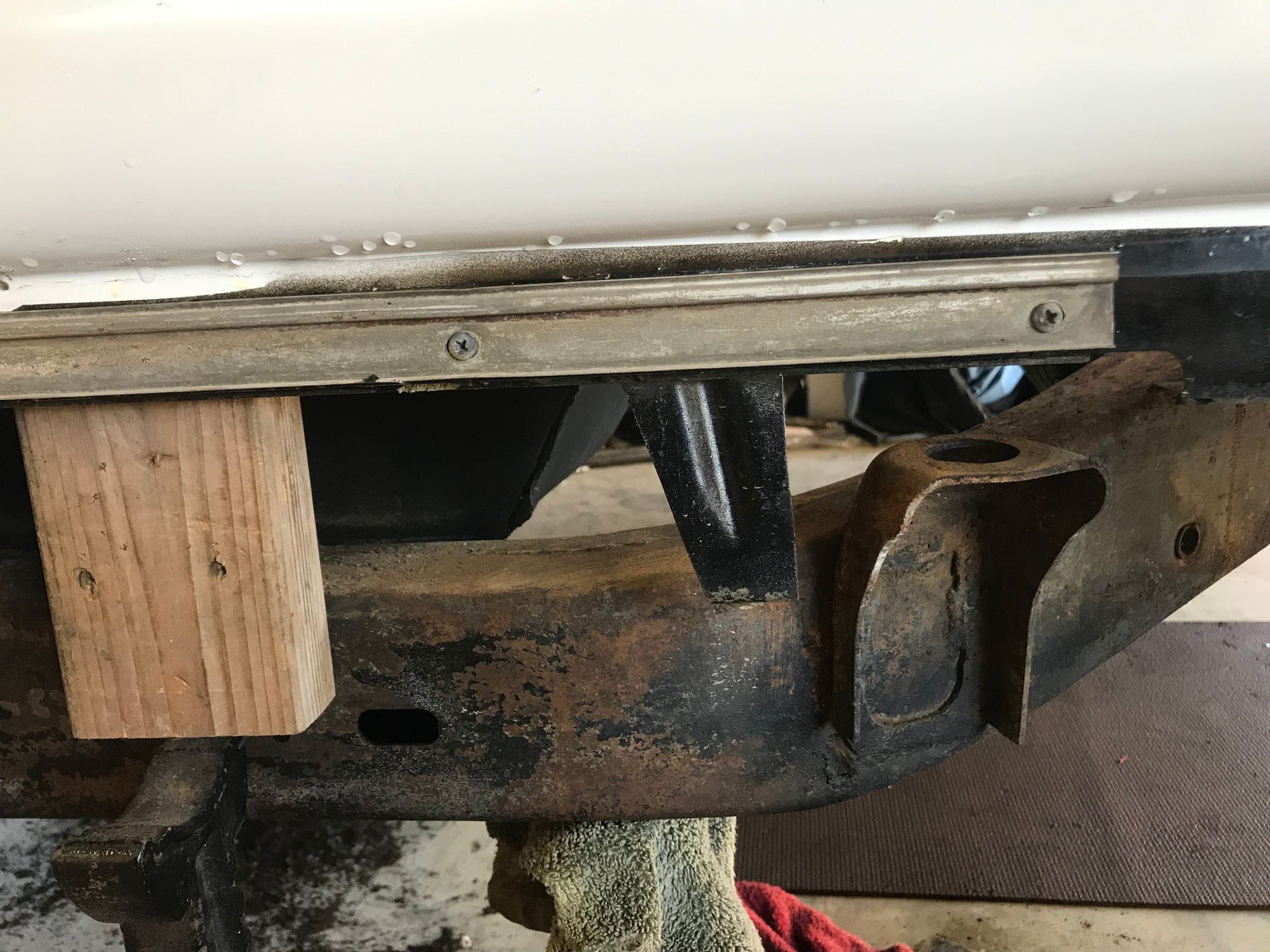

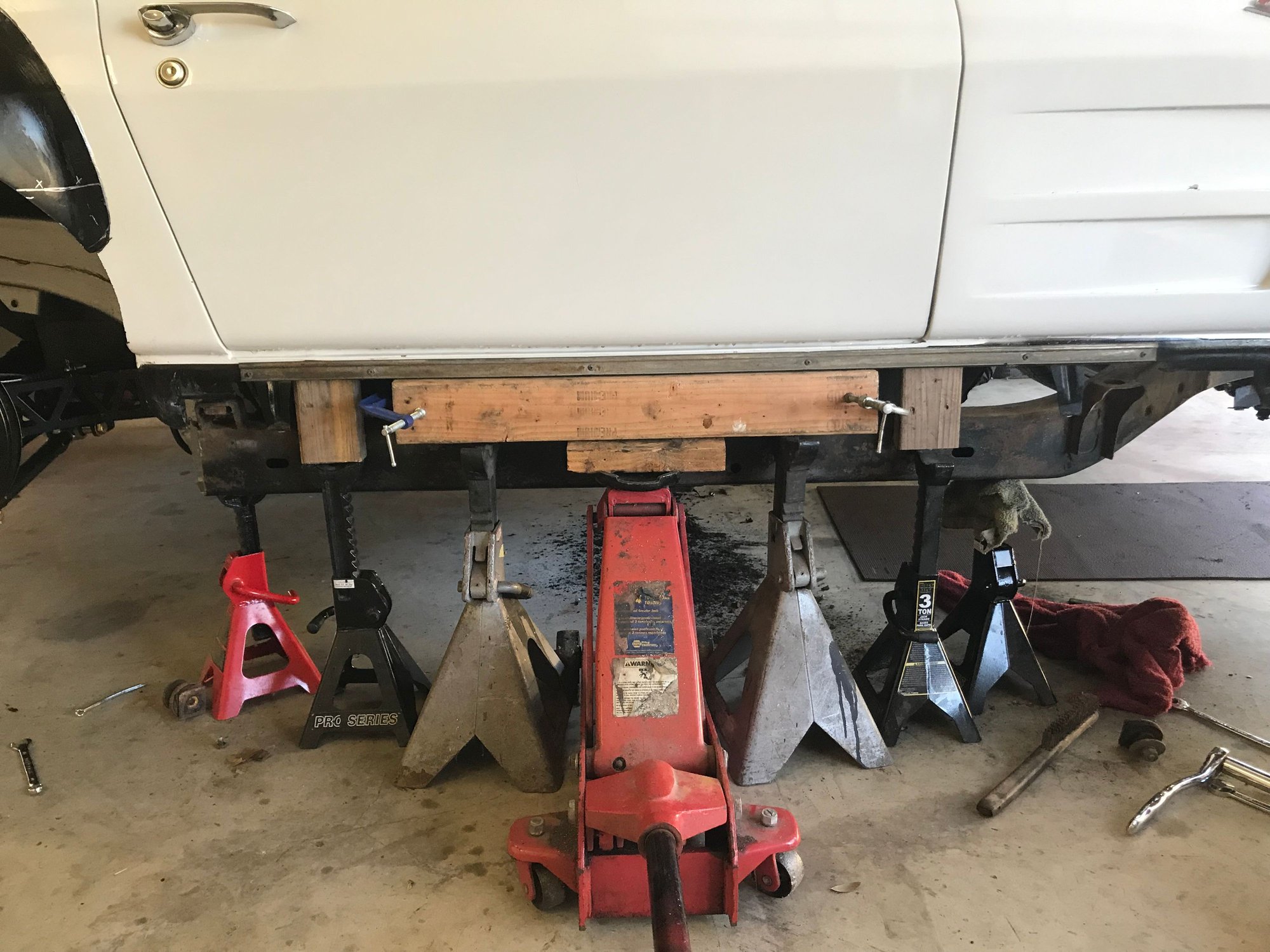

I removed the bumpers, disconnected the steering column, loosened all the body mounts and removed them on one side. From there it was easy. True, this is a C2, but the C3 is the same.
Yes I was paranoid about the Jack slipping!
I raised it up a good six inches, removed the old lines, prepped and painted the frame, replaced the body mounts, and installed new lines for efi.
I ran both ss 3/8” lines in the stock location, but did not go inside the frame at the kick up.

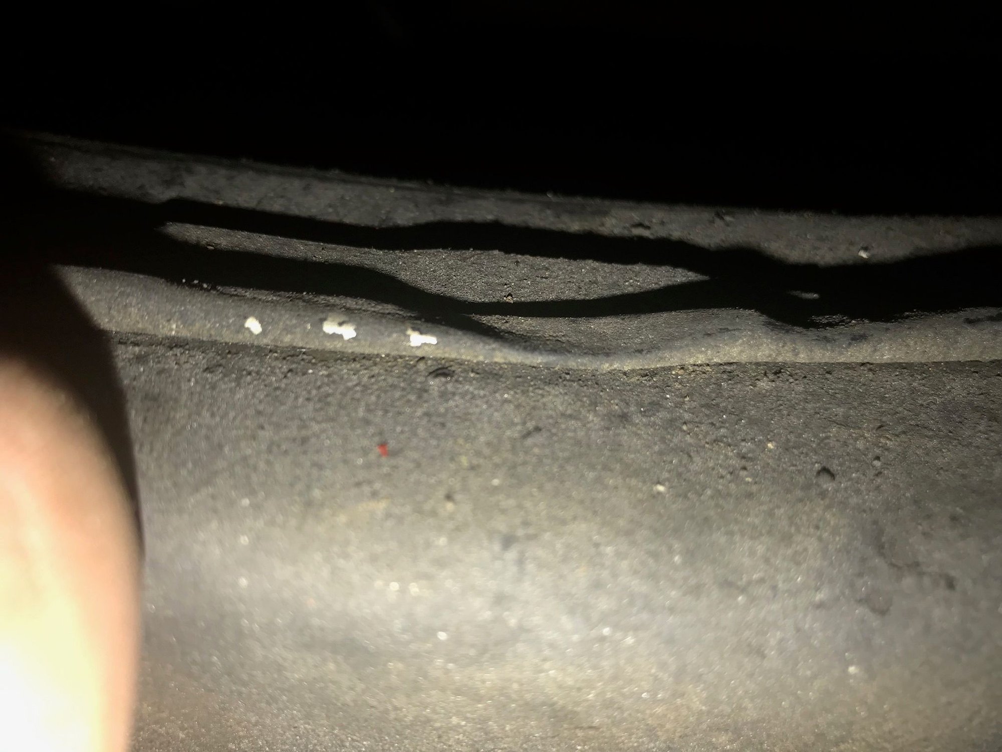

When I did the other side, I found this collapsed rear brake line right under the driver kick panel, so that got replaced.
I screwed this together to I could use my air compressor to pressurize at 100 psi and check for leak down. Passed!
Here it is connected to the supply and return lines.
