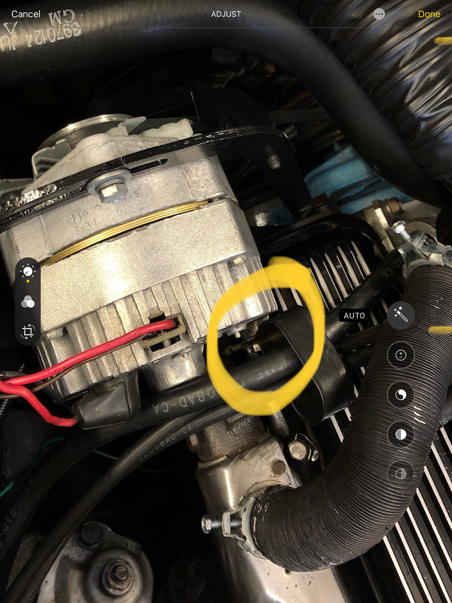

Headlights are from alternator ground..
still not sure what op means on gauges not working if lights or function
Hard to see bit black wire

Thanks for the advice! I'll try looking for the faulty ground(s) starting with the alternator. The interior & instrument dimmer wasn't affected. I guess I'll have to keep looking. Could it be the gauge panel ground or possibly the main ground strap to the frame?
