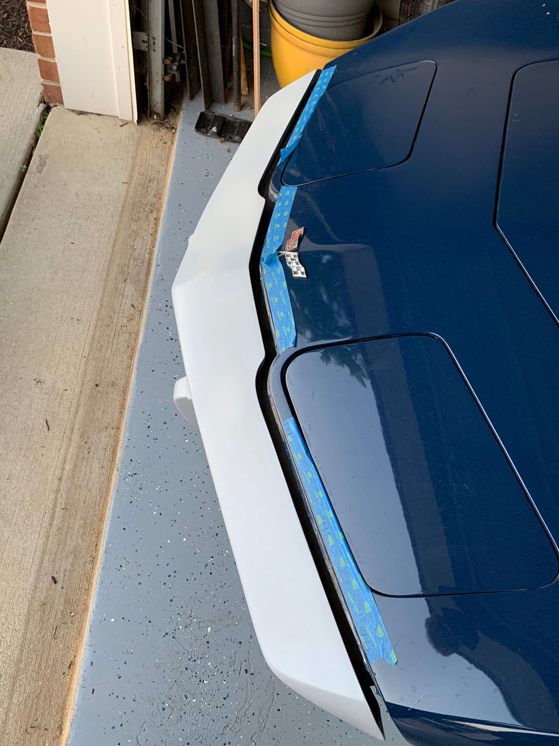

Anyone replaced the front bumper on a ‘77? I’ve ordered two of them, most recently this one from Ecklers, and cant seem to get it to snug up to the rest of the car. I’m afraid of cracking it if I try to squeeze it on. Any recommendations?

So what is it coming up against that stops it ?
What is it made from ? The aftermarket flex fit ones don,t fit without major adjustments (cutting away big areas ), even removal of the honeycomb crash piece .

I cant figure out what it’s stuck against. I might have to do some cutting. I was optimistic that it would just slide right in to place, but that’s not happening. It’s a fiberglass one, listed below:

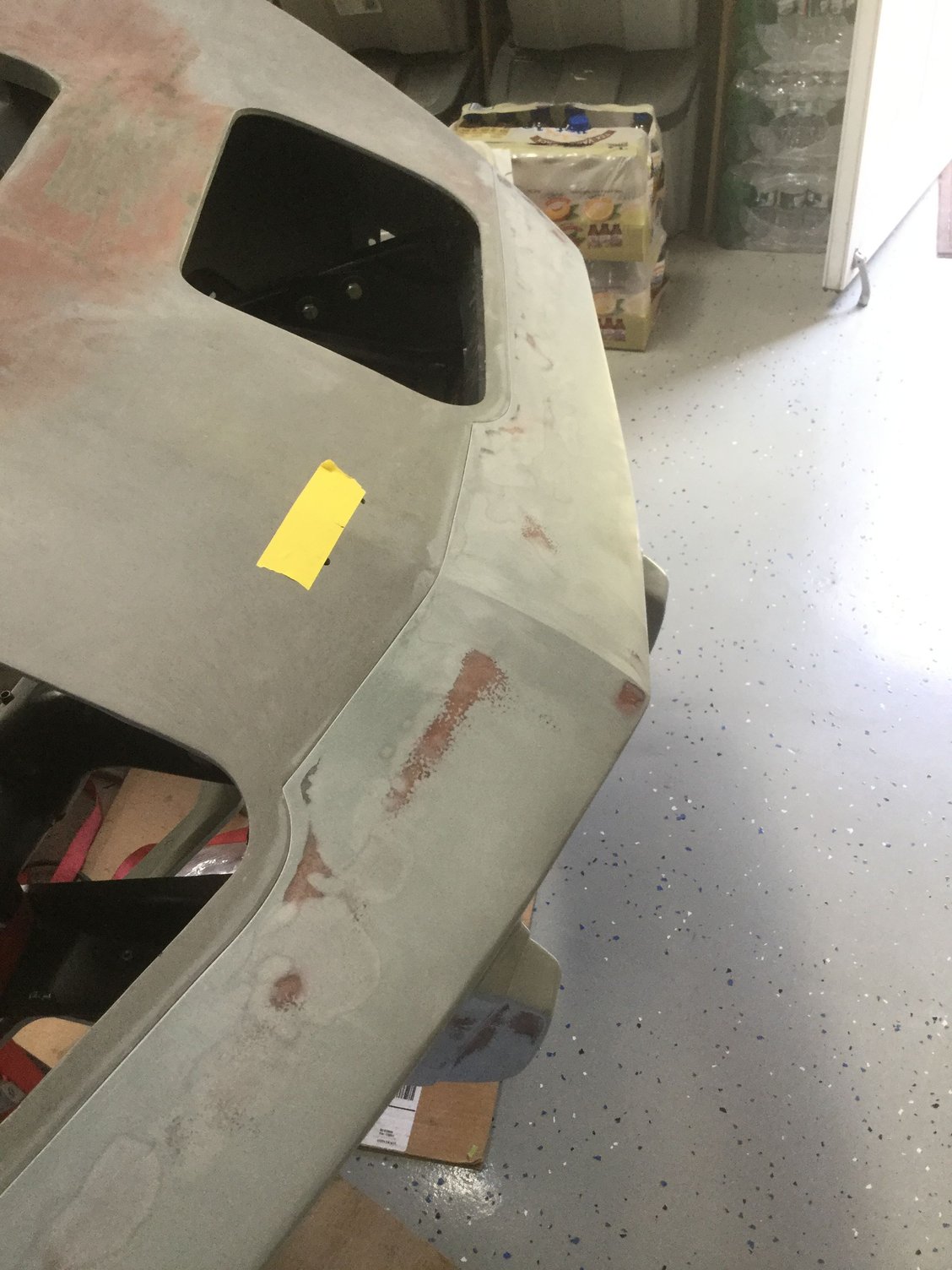

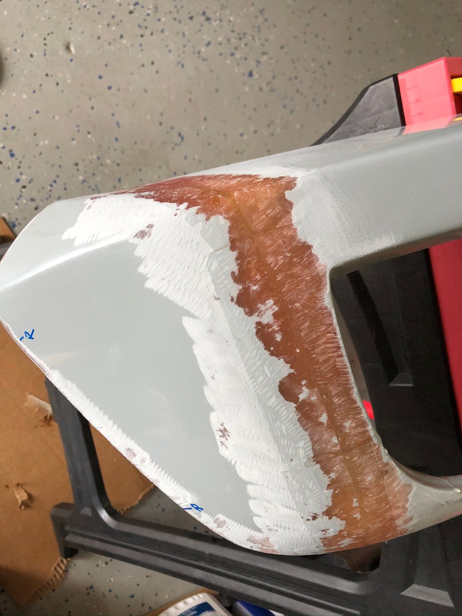

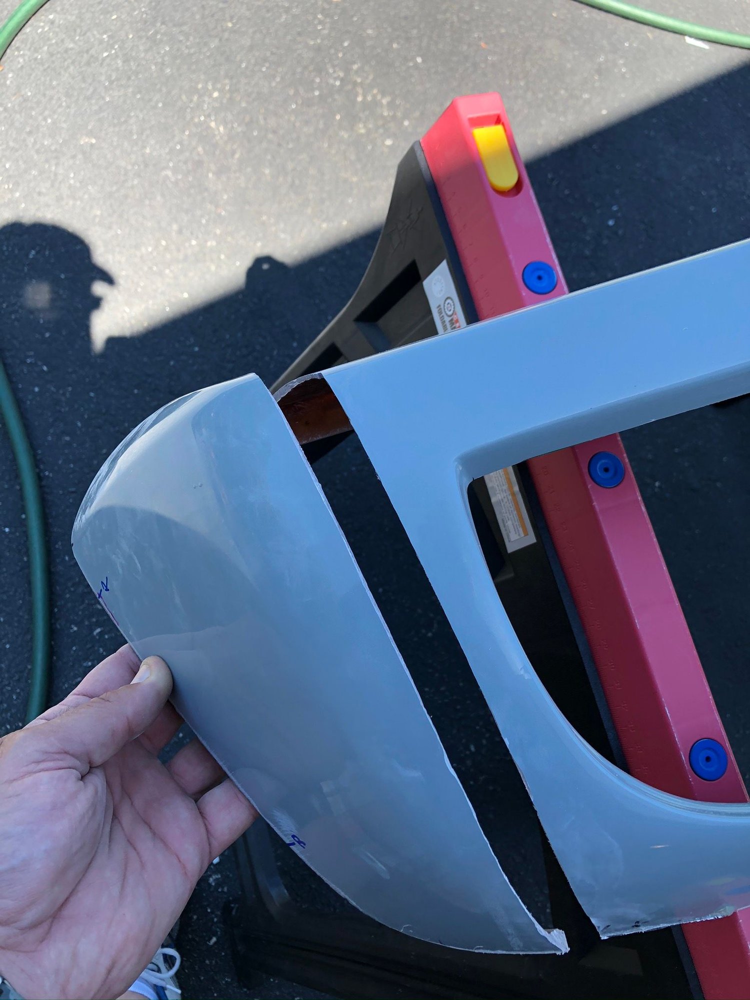

Welcome to my world! I have a 76 and got the fiberglass Ecklers replacement. It took a lot of work to get the fit to be acceptable. As some of the other folks have commented you will need to do a lot of trimming and or removal of the 5 mph components. I am not sure how different a 77 is to a 76 but in my case I had to remove the steel support on the side rubber bumpers, trim the rubber on the bumperettes( so they would fit inside the fiberglass bumper cover. There is also a steel rubber covered center plate that I had to trim 3/8” off the bottom edge and the center rubber pointed piece I had to trim a lot off of that to get it to fit. The bumper cover was actually 1/8” too wide so I had to cut and splice that ( see pic below). DUB. Had a really helpful post in the body work forum. As bazza77 said- on and off a gazillion times, is the truth. Good luck!
Cut to fit.
Back together now fits width of car.
Almost final fit, needs some small tweaks.
The painted silver steel back up plate had to be removed to have clearance on both sides.

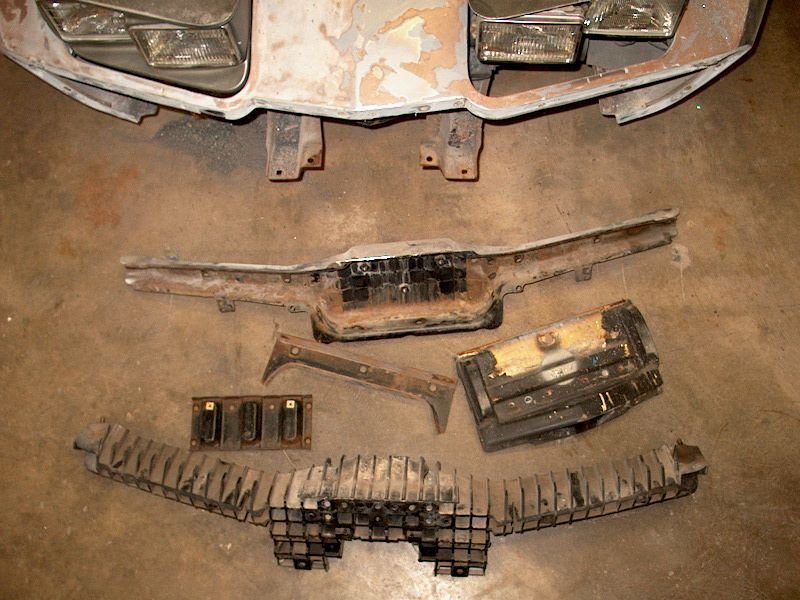

i don't think any but oem urethane will fit over the crash bars and honeycomb. that is all out on mine and the bumper fits pretty well. if you want the 5mph stuff to remain, you probably need a right angle grinder with real coarse disc to grind that plastic honeycomb down. and therre is a lot of metal to grind off too. looking down thru aerofix's headlight holes and out the valance air holes he has no bumper bars in there either. easiest is to remove all but the air tank. then a little bit of fudging to provide nose support is in order.

The license plate and bumper bar area is the biggest issue.
so i would think you would start with removing this guy. https://www.ebay.com/itm/15424472965...Condition=3000 looks like it comes off the front without taking the entire crash bar assy out. the honeycombs i think are riveted from the back side. rivets might could be drilled out from the front though.

On my 75 this is all the stuff, the big bar in the back had to have 3/16 removed with a plasma cutter on the top edge.
Also the honeycomb thing never got put back on, the 40 pound rectangle thing on the right side got thrown away.
Still had lots a adjusting to do tho on the Ecklers bumper.
