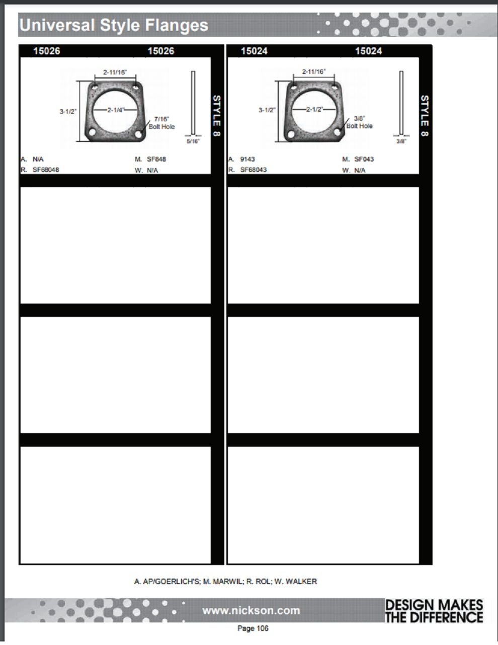

If you do have a test pipe made at a shop, supply your own flanges.
http://nickson.com/
Here are both 2.25" & 2.50" part numbers for the 4 bolt GM cat flange.
Different numbers back when I purchased mine but same 2.50" flange #SF043.
