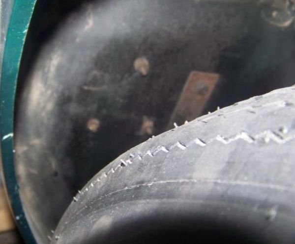

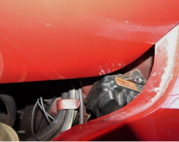

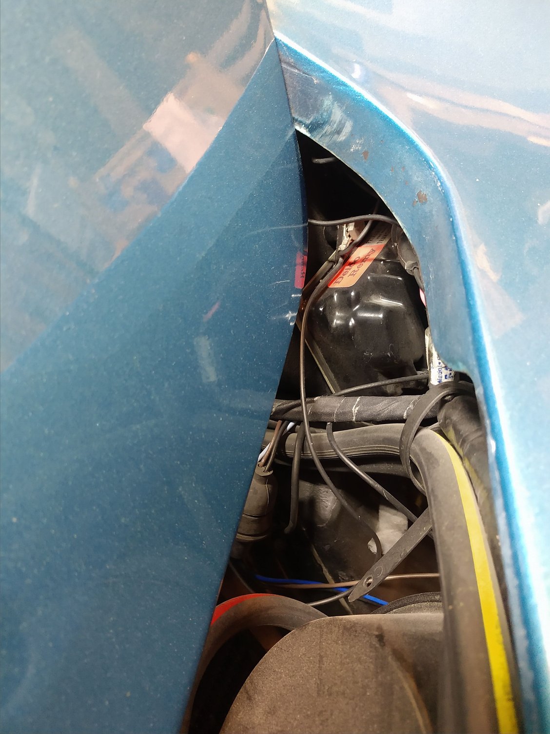

Some pictures I've accumulated. Not a '69.

I think those are the 'dimples' I was referring to.

Mine was mounted to the car when I got it but they didn't use the dimples. They missed by a little and didn't know how critical it was for placement. I will re-install it back in the same holes since it's so close.

So where was yours located? The 2 pics posted show the module in 2 different locations
. The blue zr1 has it inboard close to the hood opening. There have been cars with "notches" in the edge of the hood from hitting the module In this location.
The photo viewing from the wheelwell side has the module mounted much further outboard. Very close to the fender. That's where my LT-1 module is located. Problem with that location is very difficult to access.

Here's a couple pictures of a friends 1968 L71 with the module removed.
