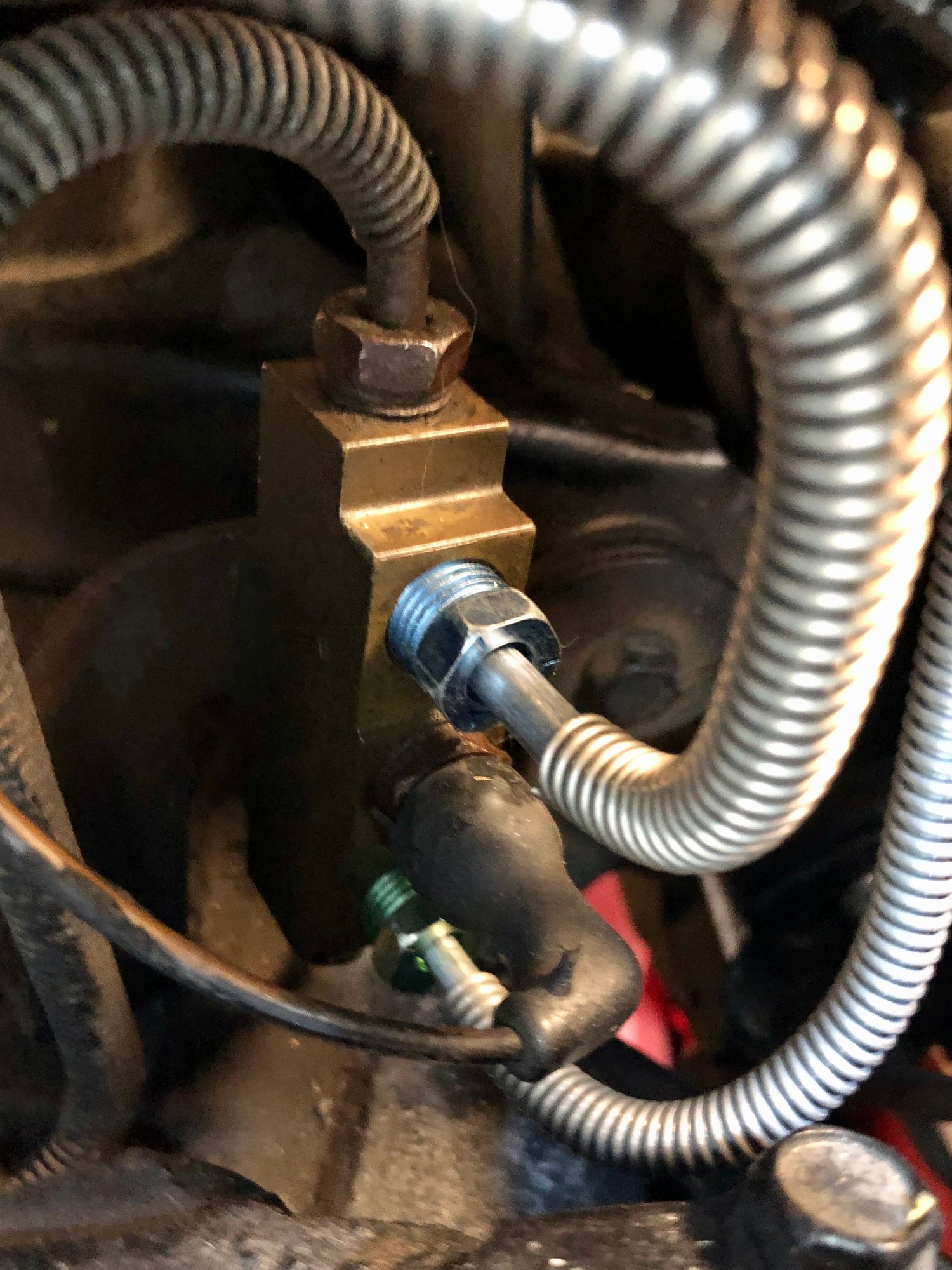

Does your master cylinder have one of these bolted underneath it?
There is a symmetrical valve/piston w/o-rings inside the block. If the piston shifts to one end of the block because of uneven pressure (leaking front or rear brake sub-system OR because of replacing brake components) it will prevent the brake system from being bled completely. It may or may not be the problem.
Let us know if the car has one installed.

DG, thanks for commenting here. My car does have one, it's in a slightly different location than yours. (see pic.) If the piston in the junction block is tripped because of unequal pressure, wouldn't that cause the brake warning light to come on? It's not on when I turn the ignition key to ON position. I know the light works because it illuminates when I set the parking brake.
