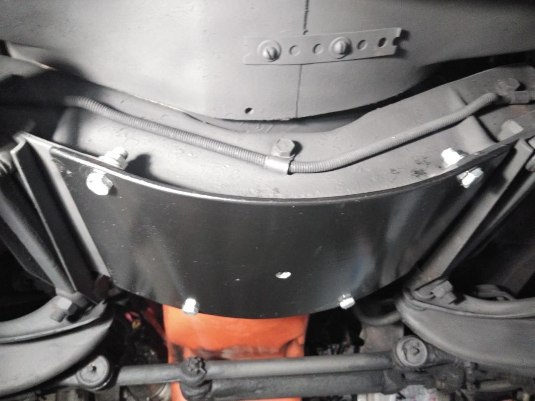

https://www.ebay.com/itm/224498285565
I bought one of these.

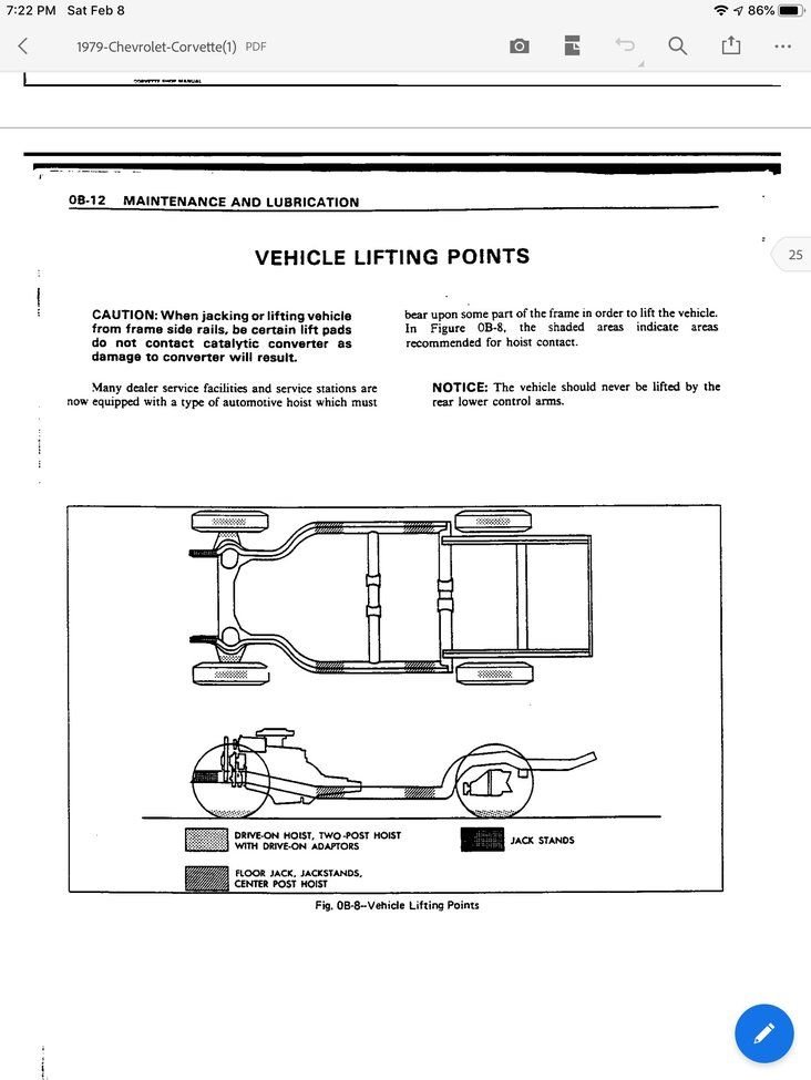

See jack and stands

I've owned three C3's and always used the front crossmember to lift the entire front end at one time. Like Kanvasman, I placed a 4X4 block on the jack. I admit the crossmember got "dinged" a little but it never affected steering or alignment. With this plate I skip the 4X4 and if anybody cares, the underneath looks "marvelous".

I've lifted both of mine by the front crossmember many times. When getting completely up in the air, I drive up on ramps, jack the rear by the differential (I need to drive onto 2x8s to get clearance, and have a splitter mounted on the jack to get around the exhaust) and secure with jackstands. Then I jack the front by the crossmember, and put jackstands just ahead of the wheels (the dark marked areas in the image above). I put a block of wood on the crossmember, to keep it from buckling.
I do all of this to prevent rocking the car on jackstands, or twisting the car by using two jacks.
Somewhere on this forum is a great how-to post on reinforcing the front crossmember.
