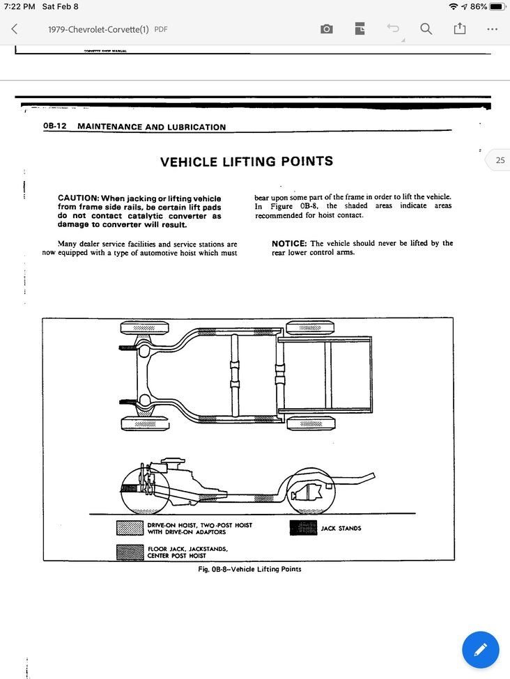

Use the crossmember, but use a piece of wood to spread the load (a short length of 51x153mm, for example?)
This is the intermediate step to getting the car completely on jackstands. The 2x8s under the rear wheels give clearance to get a jack and a spreader bar under the differential, then I put the jackstands in front of the rear wheels. Jack the front from the crossmember, and the car doesn't rock very far on the rear jackstands. Front jackstands go on the darker points in the image above, just ahead of the front wheels.
I found this method to be much better than twisting the frame, even when using two jacks.

Originally Posted by Last Triumph
Love those race ramps - but boy are they expensive for some expanded PU foam coated in truck bed liner!
Curious as to why it is better to jack stand in front of the rear wheels and not behind?
They really are crazy expensive, but I've gotten my money's worth out of them.
The frame stubs are closer to where the weight of the car is carried (by the suspension). Maybe it doesn't matter, and I've used both, but I prefer the frame stubs.
The spreader bar pictured above is how I lift the 79 by the (steel) rear spring, straddling the exhaust that passes under the differential.

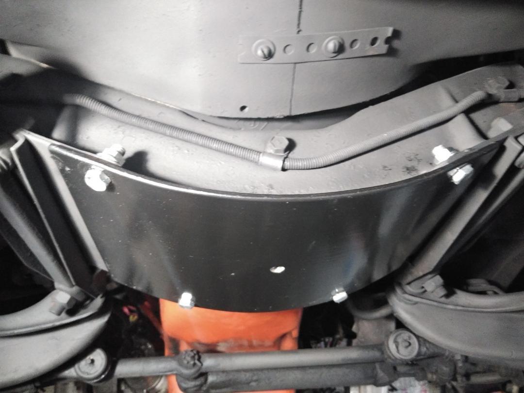

To Where to jack front end from?
Old Jun 21, 2021 | 12:02 PM
Old Man in a C's Avatar
Old Man in a C
Posts: 3,180
Likes: 297
From: Sarasota Florida
Old Jun 21, 2021 | 01:04 PM
Dino_'72's Avatar
Dino_'72
Joined: Aug 2000
Posts: 610
Likes: 168
From: Vancouver B.C.
Originally Posted by Old Man in a C
Interesting idea. Did you fab this up old man? Was it added to cover up a dented crewmember or to add protection for jacking? I seem to remember at one time you could buy a cradle similar to the plate shown in old man's pic that you could use on a jack. It fit around the crossmember so it wouldn't slide forward or back, and it had a welded pad with edges so the jack couldn't slip off. BTW, my crossmember is also dented from previous owners, and I use some wood to protect it from further damage. Never seen those spreader jack bars. Thanks for sharing.
