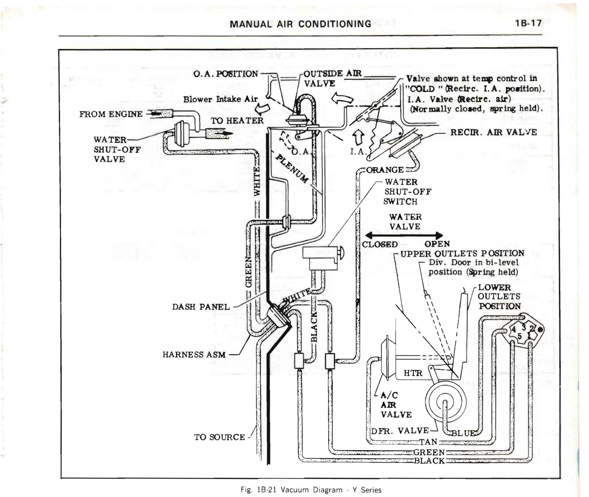

I look in through the wiper trough and i can see the blades on the heat-a/c fan. i do not see a deflector-door that can close that off. does recirc just add cabin air to the incoming fresh air? or am i missing something. 75 with later parts to do DIY VIR eliminator.

Eric P's Avatar
Eric P
Joined: Aug 2019
Posts: 1,508
Likes: 496
It should block off out side air completely , haven't had my Vette apart yet to see how it exactly works or researched it in the manual but every other car I have worked on in a America is that way

7T1vette's Avatar
7T1vette
Posts: 37,637
Likes: 3,116
From: Crossville TN
'Recirculate' just blocks off outside air and continuously circulates the same inside air....until it gets to a 'reasonable' temp inside. Then you move it over to 'normal' A/C to get a mix of fresh air and inside air. That is so you can continue to find oxygen in the cabin....

bmotojoe's Avatar
bmotojoe
Joined: Oct 2007
Posts: 4,367
Likes: 1,730
From: Seattle Area Washington
A/C MAX Plenum door closes, recir. door opens.
A/C NORM Plenum door open, recir. door closes
Plenum Door & Actuator LINK:https://www.ebay.com/itm/254552147206

derekderek's Avatar
derekderek
Posts: 13,082
Likes: 3,399
From: SW Florida.
ok. i see it now. i was looking at the back of the flapper, not the side of the box. actually, though, we can check our fan squirrel cage for squirrel nests without doing anything more than opening the hood.

interpon's Avatar
interpon
Joined: Jun 2019
Posts: 7,649
Likes: 2,466
From: Indiana
my 79 states you will ALWAYS get SOME outside air even at recirc setting..just less
