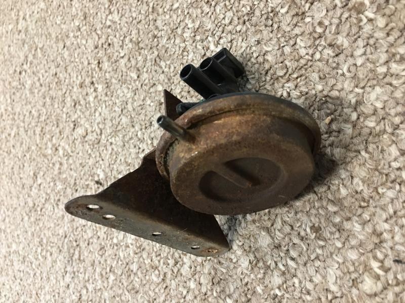

Hey Catfish, I'm replacing it because I tried cleaning the old one and used a harsh chemical that took off some of the finish -- big mistake on my part and it really looks lousy when I show it. That is the only reason.

Understand perfectly! Mine was 'ugly', too. I sent it (along with my headlight relays) to a fellow in Texas who restores/refinishes them.

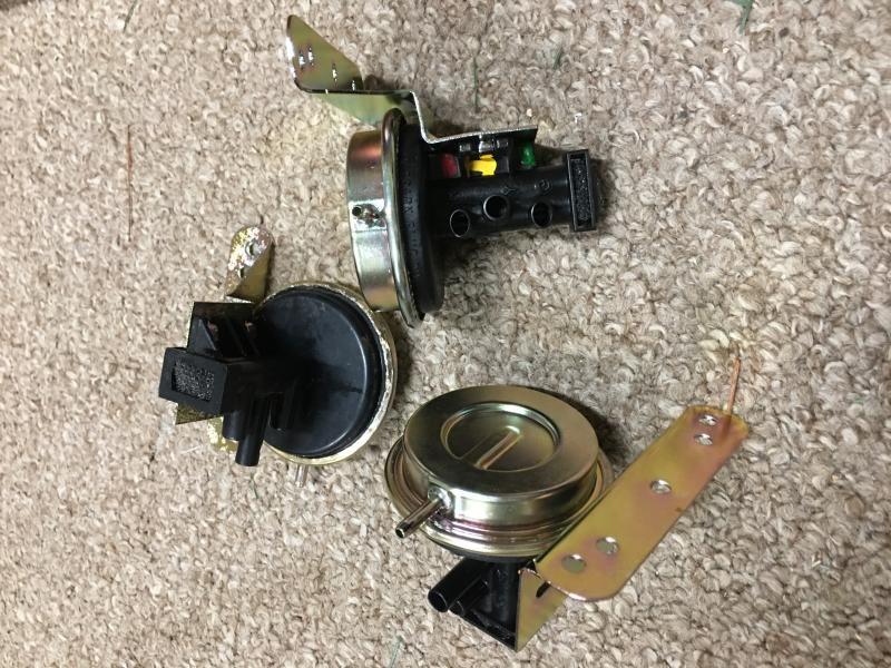

Here's photos from work he did in late 2019. I see you're in Spotsylvania - I'm 10 minutes off I-95 Exit 61 if you ever want to take a look at them.
