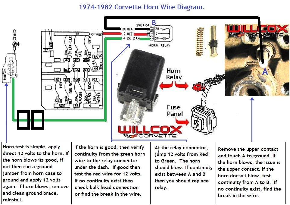

For the horn not working, follow these instructions

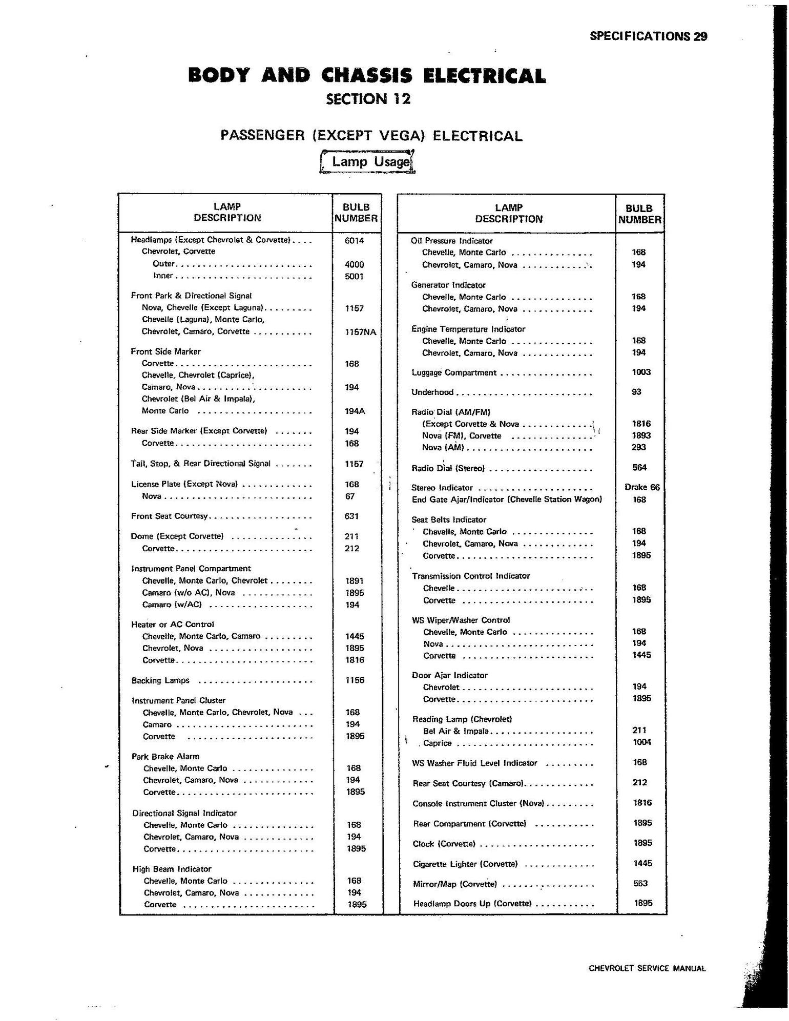

While your waiting you might want to get some new bulbs.
The 1157 bulbs have a high and low pin be sure to put them in the sockets correctly.
