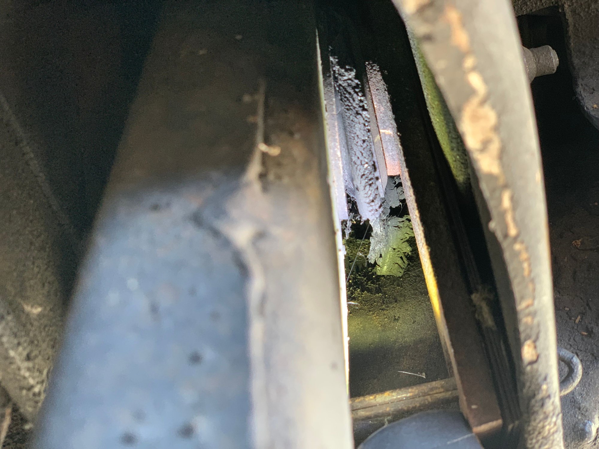

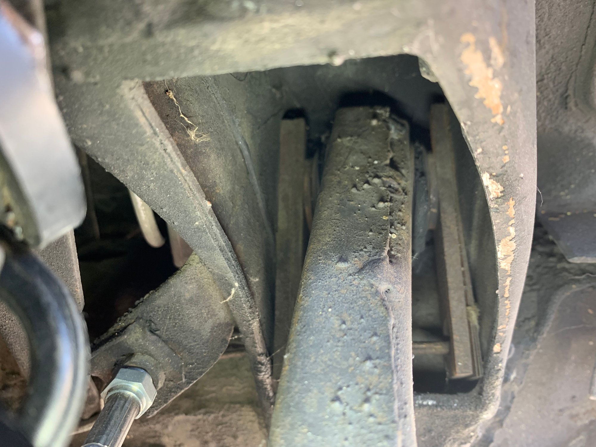

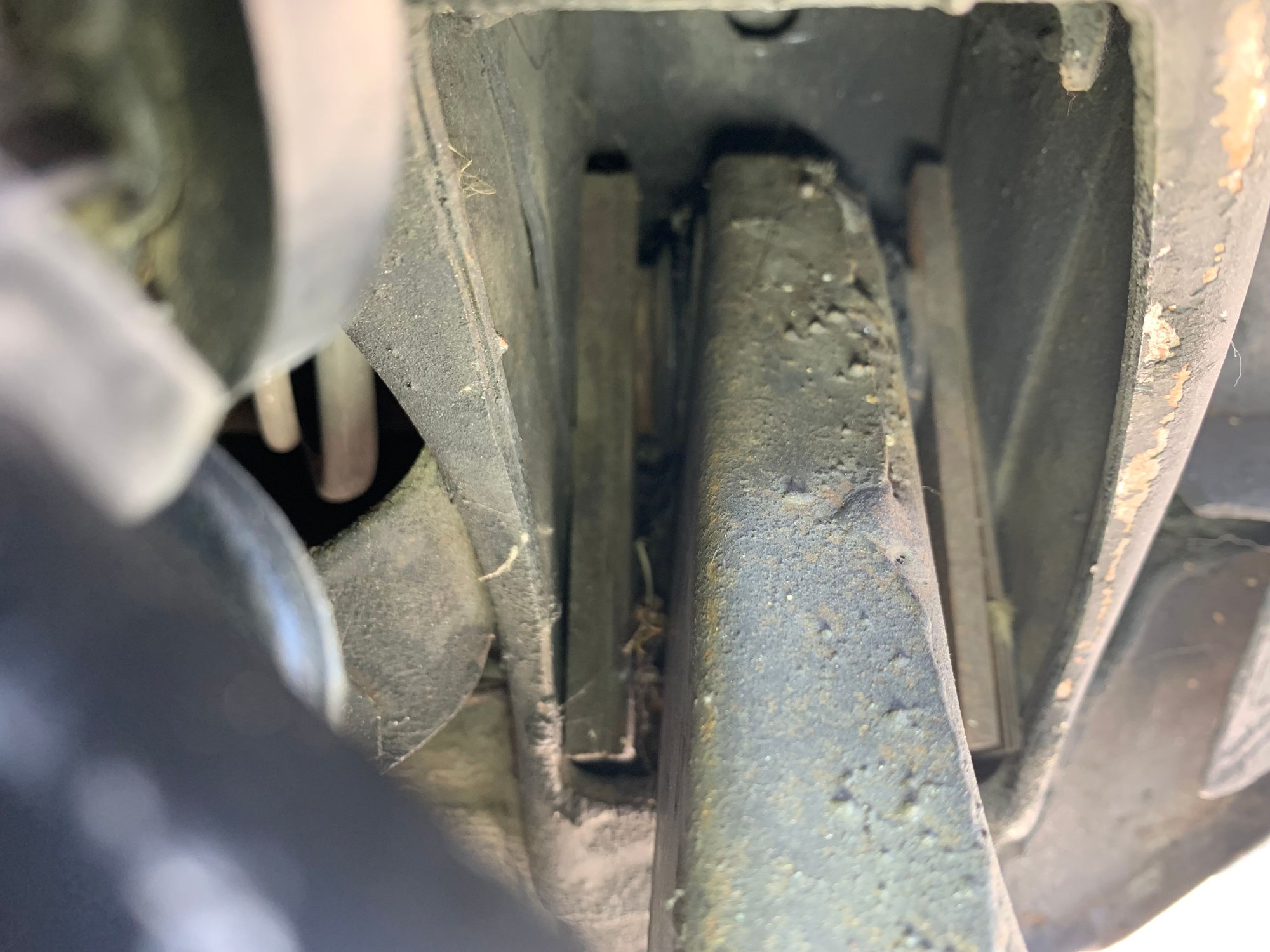

Sorry if I wasn't clear, I replaced the rear Strut Rods, all 4 shocks and had it all aligned afterwards.
This morning, I lifted the rear of the car and see if there was any play on the rear tires. I checked at 12 and 6 and at 3 and 9 and found no back an forth.
I pulled off the rear tires and everything is tight and nothing looks warn. The only thing I haven't changed are the trailing arms. I took a few pic's and while warn they look ok, I think. Don't see any movement there but that may be because I can only apply so much force manually.
Do these look ok to you all?

Now that I look really close I can see the bushing on the Trailing arms are in pretty sad shape on the bottom.
Is that something I want to do or just send it out?
Do I have mine rebuild or purchase new ones?
Other then the u-joints what else should I replace while I'm there?

Looks like bad trailing arm bushings to me. That bushings or the bearings are about all you haven't changed that could cause spooky handling. Test them as mentioned first before you decide to fix them.
Pulling them is a pretty big job. But rebuilding them is even bigger and requires specialized tools and knowledge. I'd suggest rebuilt ones from Van Steel, Zip or Bairs, or others.
That MAY be just the rubber that is exposed and not necessarily a bad bushing.
Use a big screw driver or pry bar and see if the trailing arm moves side to side.

I figured before I went much further to take the tires off and confirm that the bushings are the problem. I used a small crowbar and as you see in the video I don't see any movement. Did I miss something? Is the trailing arms the problem or should I be locking somewhere else?
https://drive.google.com/file/d/1psE...ew?usp=sharing

Not a expert here, but I don't think that is your problem. And, it's a big job to replace the bushings, get alignment, etc. if it's not needed.
