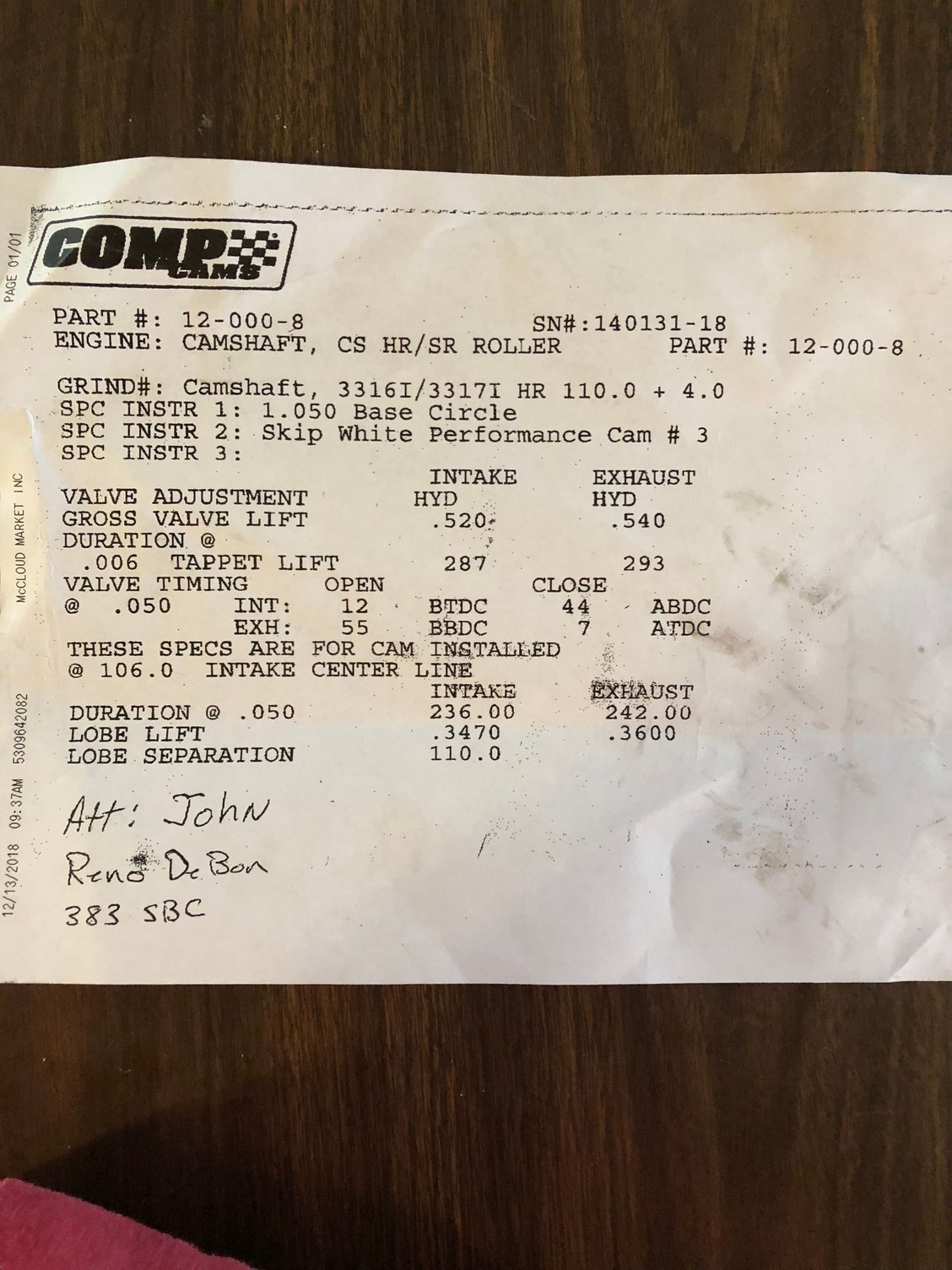

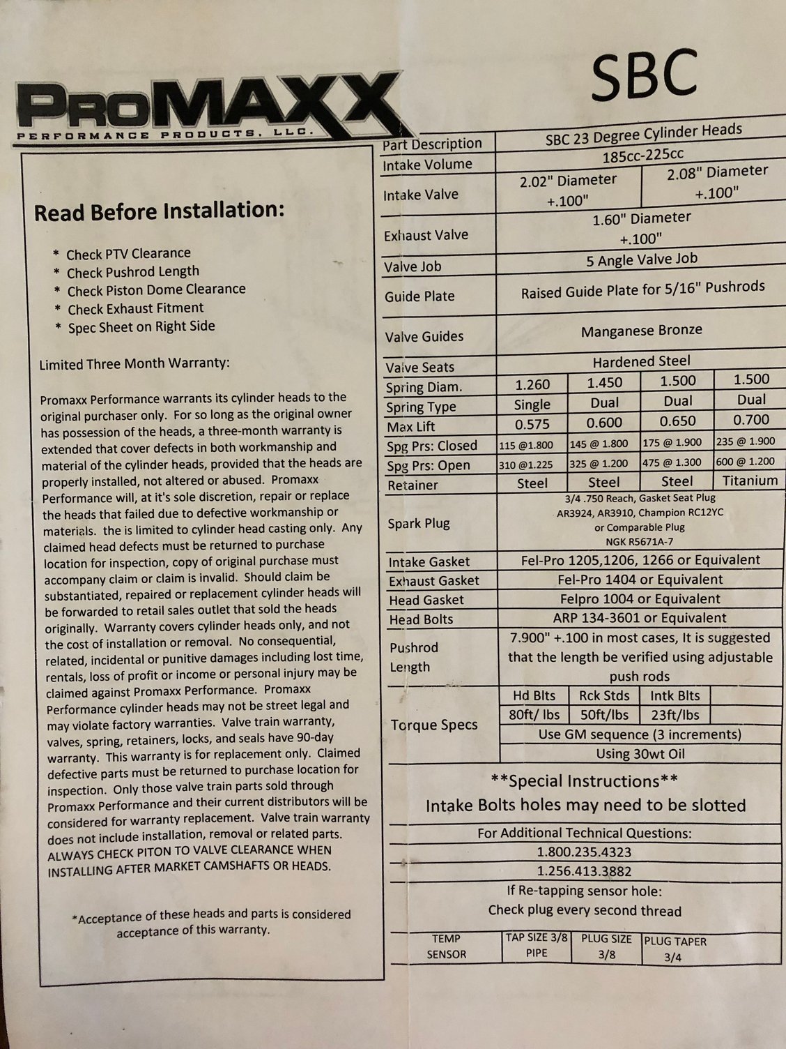

C2 of Year Finalist (appearance mods) 2019
This cam and heads will do it

BK , it sure isn't going to have 400 RWHP
Old Jul 6, 2021 | 06:28 PM
derekderek's Avatar
derekderek
Posts: 13,082
Likes: 3,399
From: SW Florida.
not with a 262 cam.
