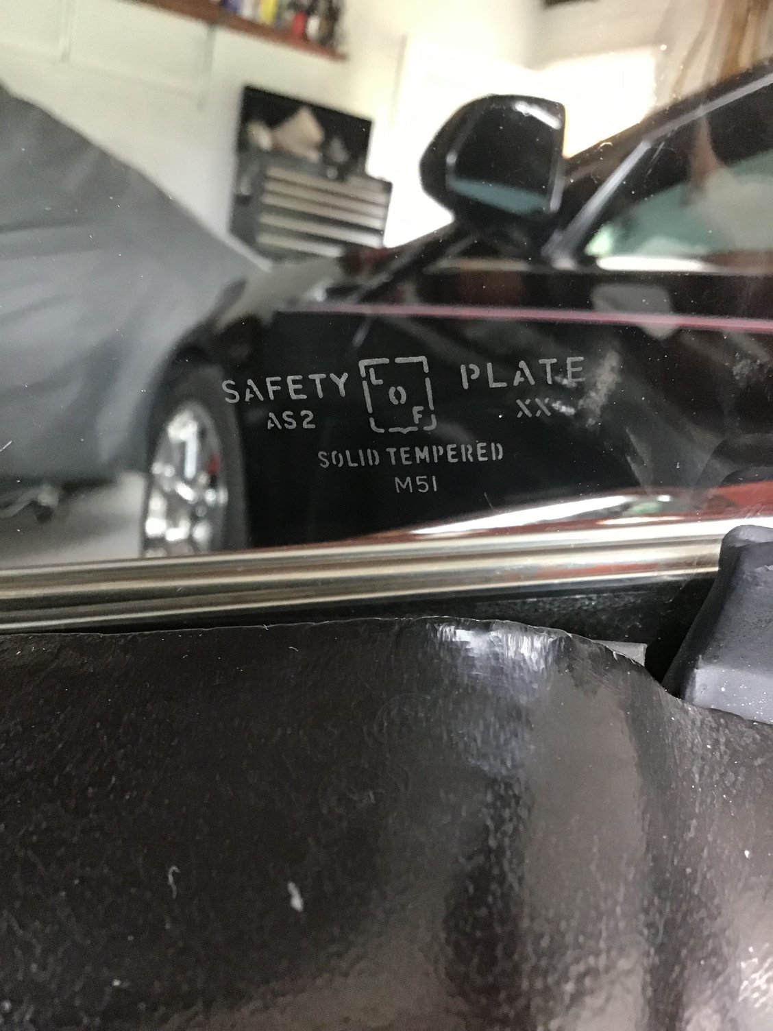

Ok…just checked, markings are visible by the door handle. They read
Safety AS2 (LOF inside a outlined block) Plate XX
Solid Tempered
M51.
I have no idea how this would be a date code.

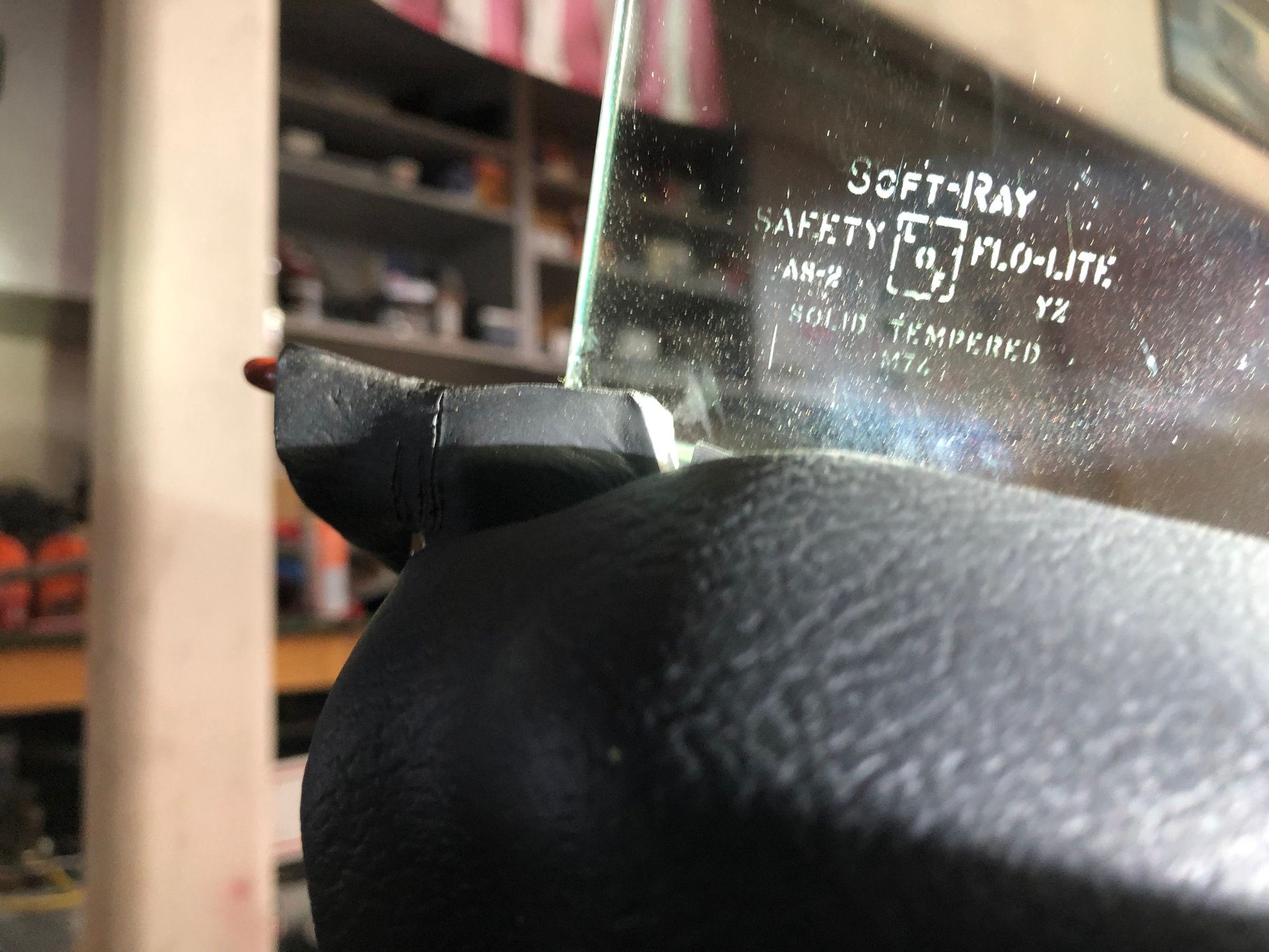

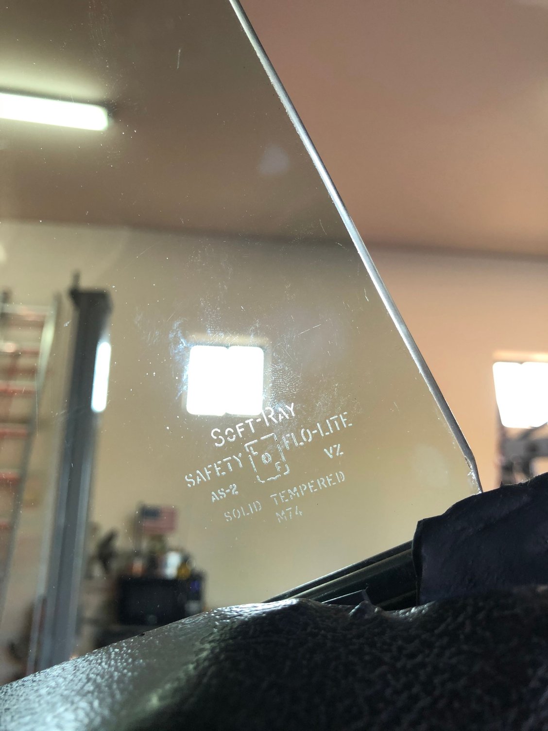

The date code is a two letter code. This door glass is from December 67
This door glass is from October 67. Mine are both marked M74 and that is the manufacturers model number.

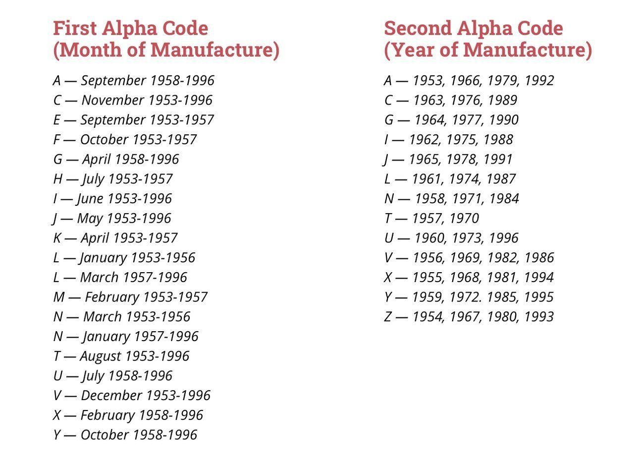

The code XX would be February 68. Maybe your glass was replaced?

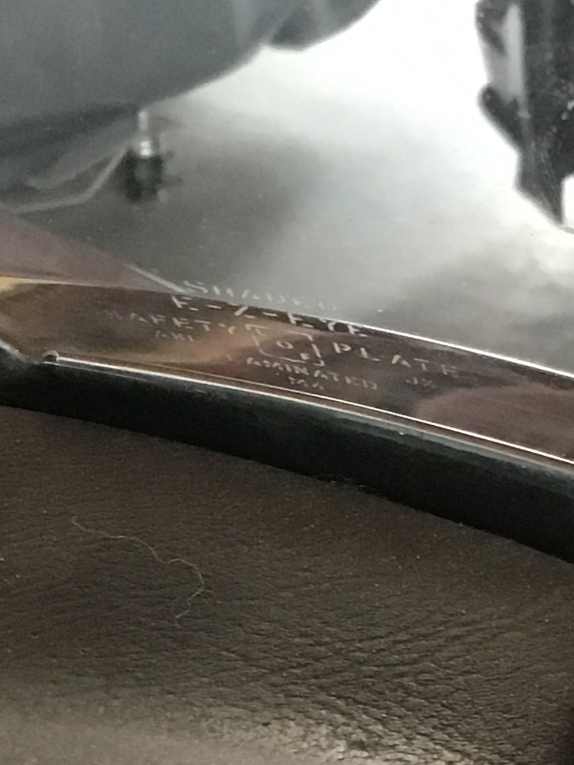

To confuse matters further, the windshield is marked JX which is May 1968.
Why would someone replace all the glass, assumed within a year of manufacture??

Glass Codes:

Just for the records below are pictures of my window glass, windshield glass and protecto plate info.
Something don’t jive.
Window
Windshield

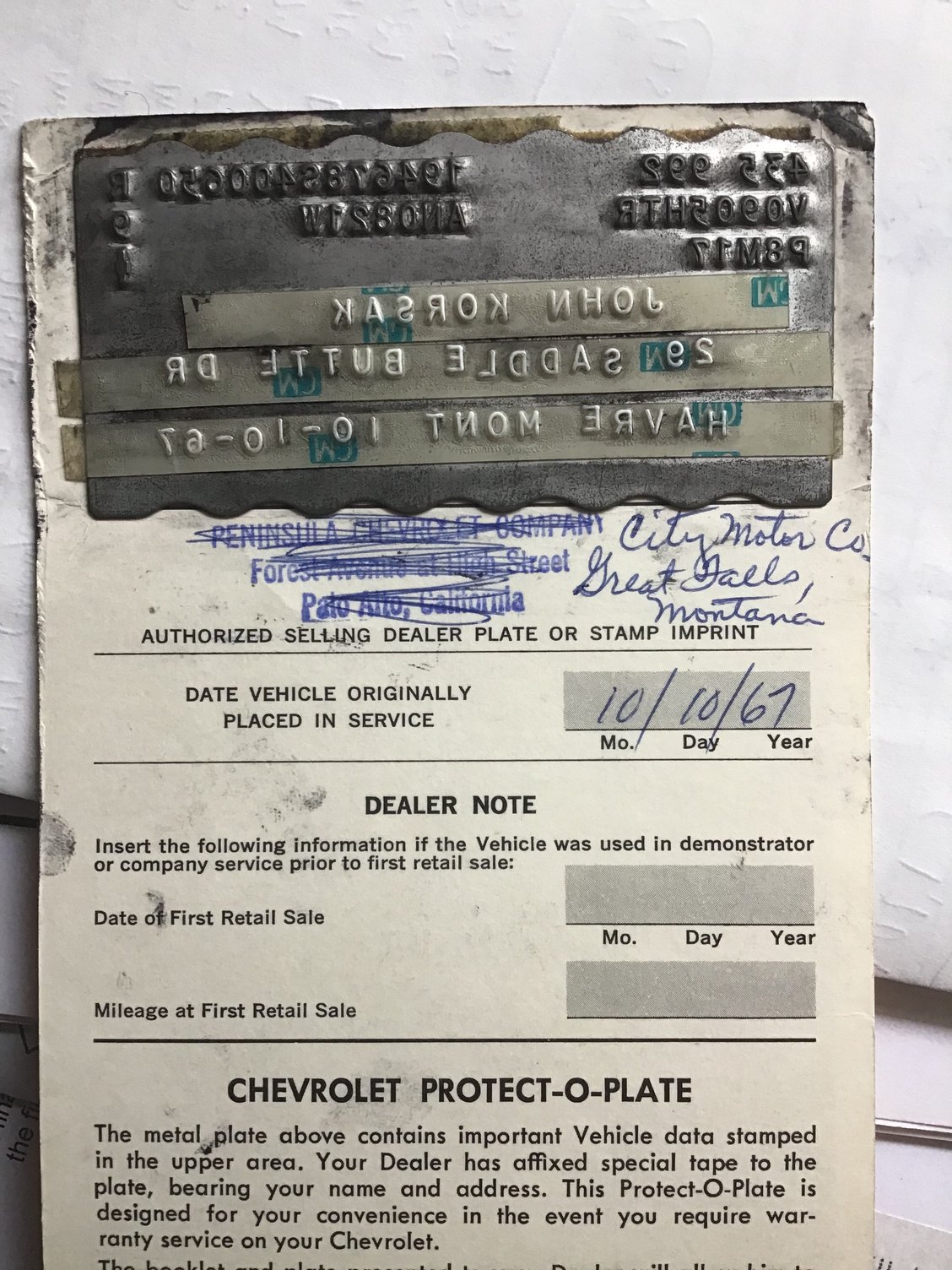

Protect-o-Plate

Your protect-o-plate is fine. All the date info lines up with the vin number.
Your glass has been replaced. A production windshield wouldn't use the wording Shaded E-Z-Eye, it would have been Shaded Soft-Ray, or Shaded Soft-Ray Tinted.

Thanks, the protect-o-plate aligns with the car stamped VIN and block. Was trying to restore the car to as original as possible. Wasn’t expecting all the glass to be a problem I won’t fix. Was just trying to figure out if the side windows should have the Astro Ventilation script.
