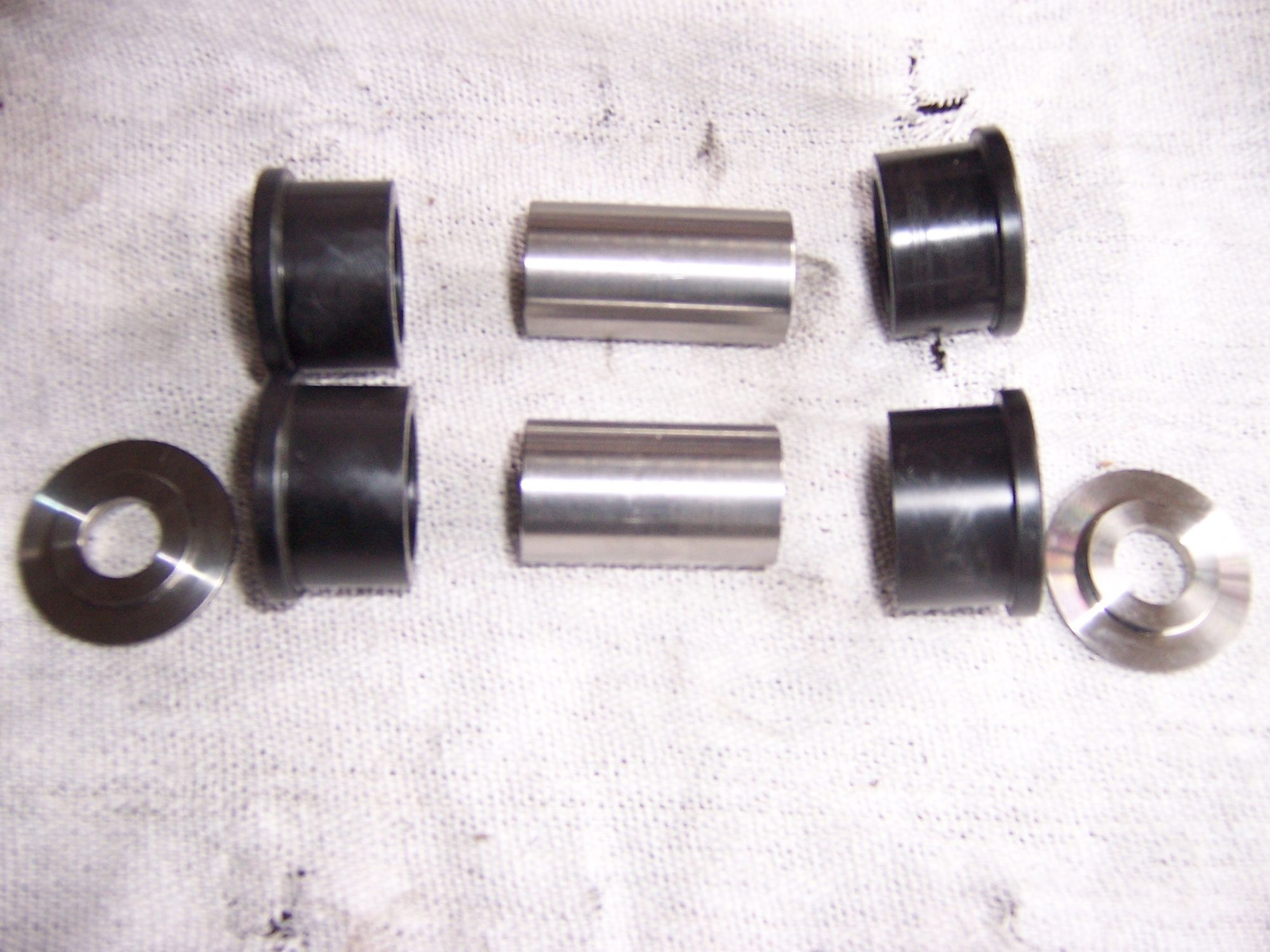

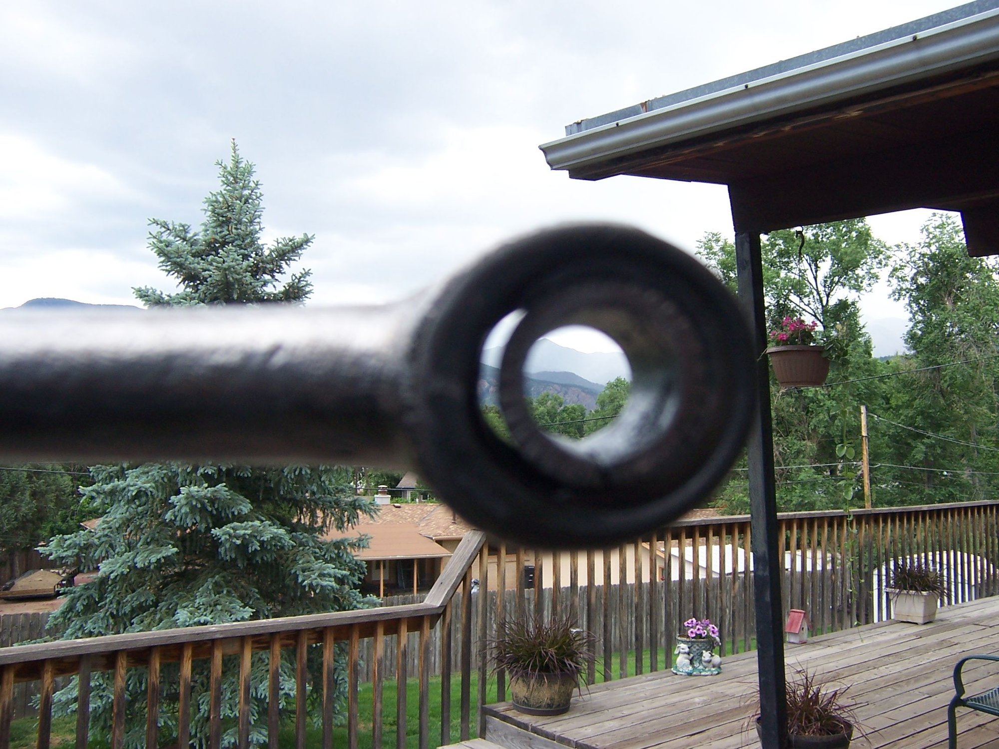

OP, if your original bushing are in good condition I would leave it alone. I do not recommend the cheap aftermarket china made rubber bushings available from most Vette vendors. Maybe it was just my dumb luck, but this is what happened to mine after less than 2 months of service when I noticed the rear wheel camber starting to fade. The rubber had no rigidity and squished out of shape.
I ended up machining my own bushings out of Acetal/Delrin rod, and washers and spacers out of stainless steel to retain the mostly stock appearance of the installed strut rod.
So far so good and the alignment has stayed rock solid for the past 4-5 years. If stock appearance doesn't matter to you, adjustable rod with heim joints is probably the best option with poly bushings a close second.
