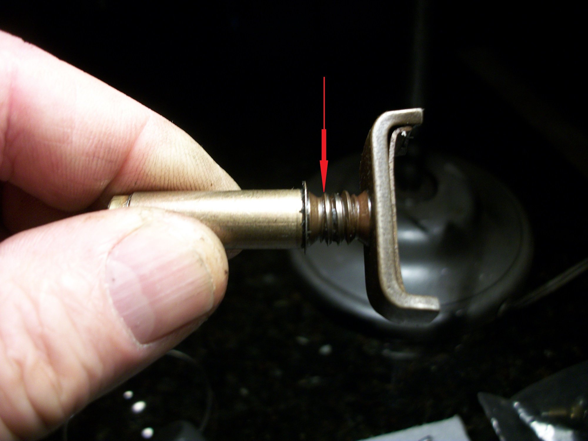

My '68 does not have cruise so I can't advise you about that part. I have some pics in my thread about the odometer problem I experienced.....it may or may not be the cause of your problem.
You can unscrew the speedometer cable at the transmission to see if the plastic gear inside has worn teeth or the female end of the gear shaft is rounded rather than square-shaped.
The link below will take you to the speedometer repair in my thread.
NOTE: Removing the speedometer from the dash should be a LAST RESORT after all other repairs fail to solve the odometer problem.
https://www.corvetteforum.com/forums...post1590139457

Originally Posted by Geoff Leach
The cable from the Speedo to the cruise unit is only short so when I turn the inner cable it turns a few turns ok the gets stiffer so the problem must be inside the speedo as it’s not moving the miles meter but the speedo needle is moving with the little jerk when it gets tight .you’ve got your work cut out there bud , we’ll done to you .Geoff
The pics below show the damage that caused bouncing needle/inop needle........inop odometer also.
Removing shaft @1 with damaged teeth
Damaged teeth om mating shaft.......
