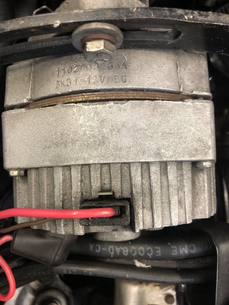

What kind of metal is the outer case made of - what can be used to clean it up to look like new again?

They are made from cast aluminum.
You can simply spray paint them with flat aluminum paint.

Aluminum. And I would highly recommend using VHT "flat aluminum" paint. The best method for doing so would be to disassemble the alternator to get the bare outer shell. Wash and dry it, then shoot a couple of coats of VHT. Let dry overnight, then bake it to convert it to a ceramic coating (per instructions on the can). I did this almost 10 years ago and the alternator still looks just like it did that day!!
