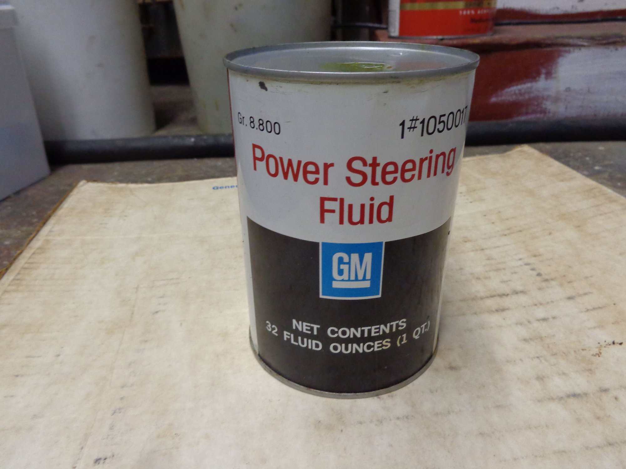

From: MA
This is what i always used

Likes: 3,335
That's the stuff
