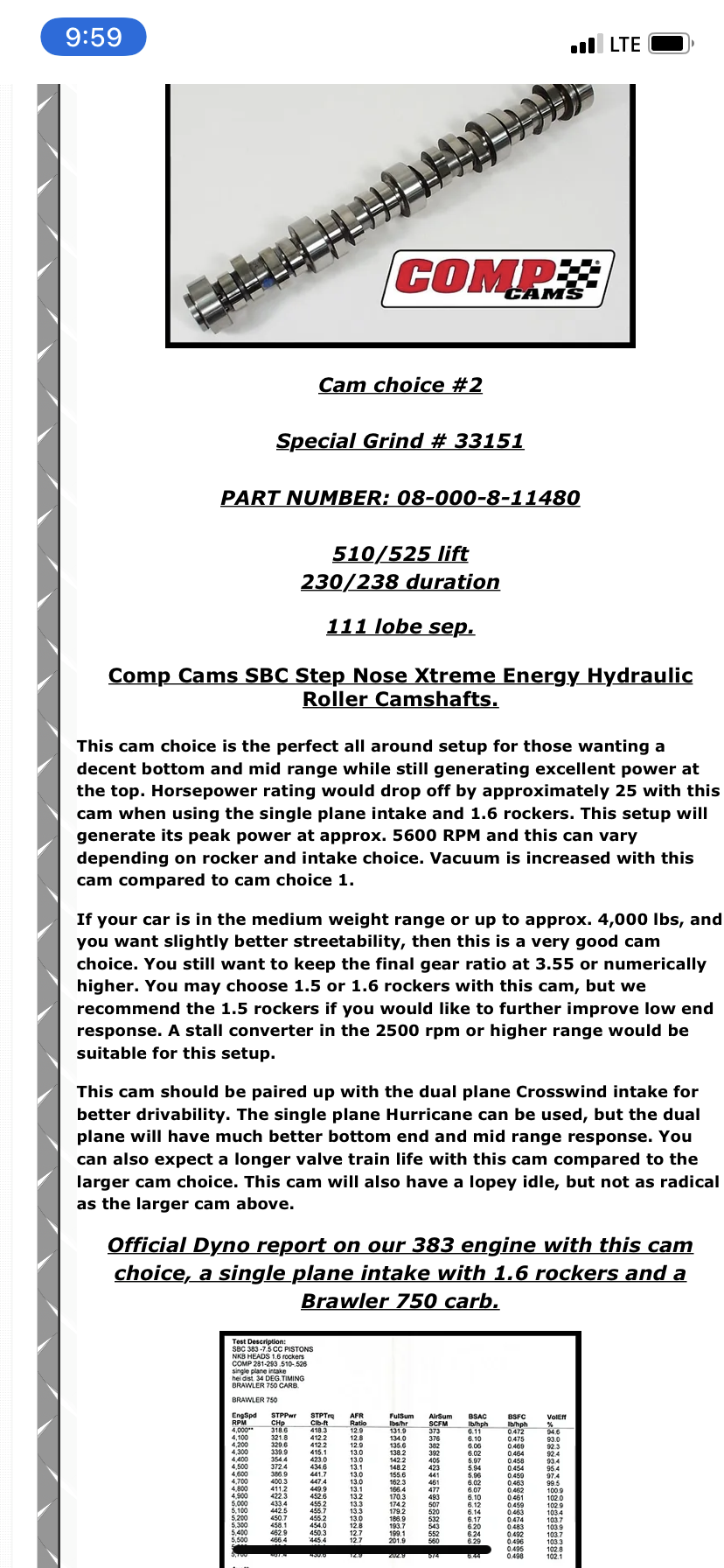

I’m considering going to an electric vacuum pump for either the headlights or power brake. I seem to only get enough vacuum in my 383 for either or but not both. Anybody recommend some pumps I could look at or your experience with this install?

Just use a larger vacuum cannister or swap things over to electric. What size cam are you running? What is your vacuum reading at idle?

I’d like to do the electric headlight swap but not sure I’m ready to spend the $. If I remember right, I’m getting about 12-15 on idle. Cam below. Currently using manifold vac for dizzy and power brakes. When I plug in the headlights they don’t function unless I disconnect dizzy for headlights.
