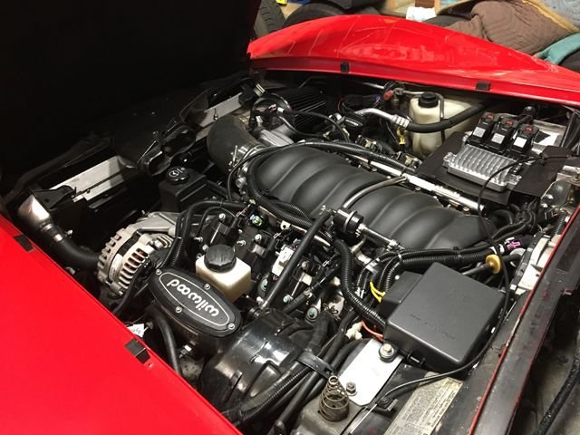

Well intended use is a big guide as to what changes are feasible, budget , DIY project, or for something to do project. here is my 78 which started as a L48, went to a ZZ383 and now a LS3 / 480. My intended use is for track days. Also I still have the L48 as original
and can swap the LS3 out and reinstall the L48 to return back to numbers matching original car. No modifications where done during the LS3 swap that would effect any original parts or mounting of factory parts.
Some people do a cam / heads to L48's to improve performance (lowest budget) / crate motor swap SBC 350 / 383 using factory type parts etc.

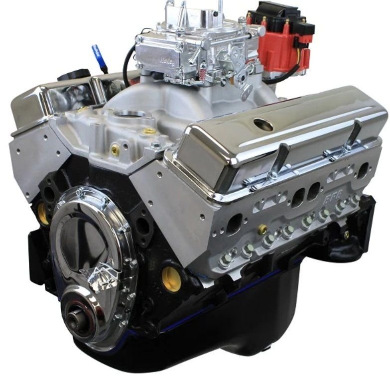

OR he might be interested in a 350 from Blueprint Engines since he wanted an L82 to begin with, so something not as wild as the 396, but not as mild as an L82!
https://blueprintengines.com/product...or-bp35513ctc1
