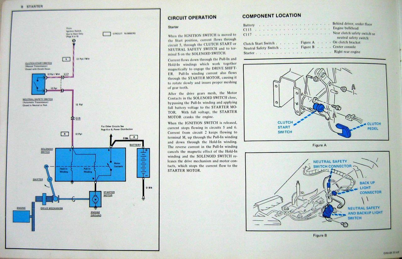

Check if the purple wire gets power when you start it

You can find a wiring diagram here, but what @bruiser posted is excellent.
http://wordpress.keystonestatecorvet...m/?page_id=118
If you want to live dangerously, you can wire in a separate, switched 12V source to the solenoid terminal with the purple wire. People often do this to bump the engine when doing timing, for example. But absolutely start with a voltmeter.
