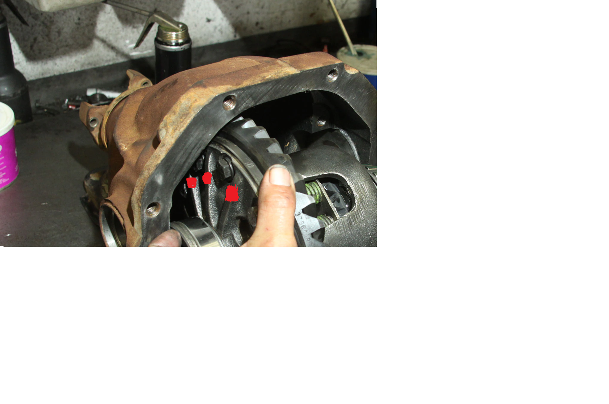

I took apart my differential today to replace the clutches and I noticed chunks of metal sitting in the gear oil that I emptied. I noticed significant damage to the carrier where the ring gear attaches but no damage to any of the gears so I'm not sure what may have caused the damage. I don't have a picture of my own differential but I will add a picture of where the damage is located. The location of the damage is marked in red.

That is damage from a ring gear bolt backing out in the past. Look for gouging on the left side of the housing. Not uncommon to find.
