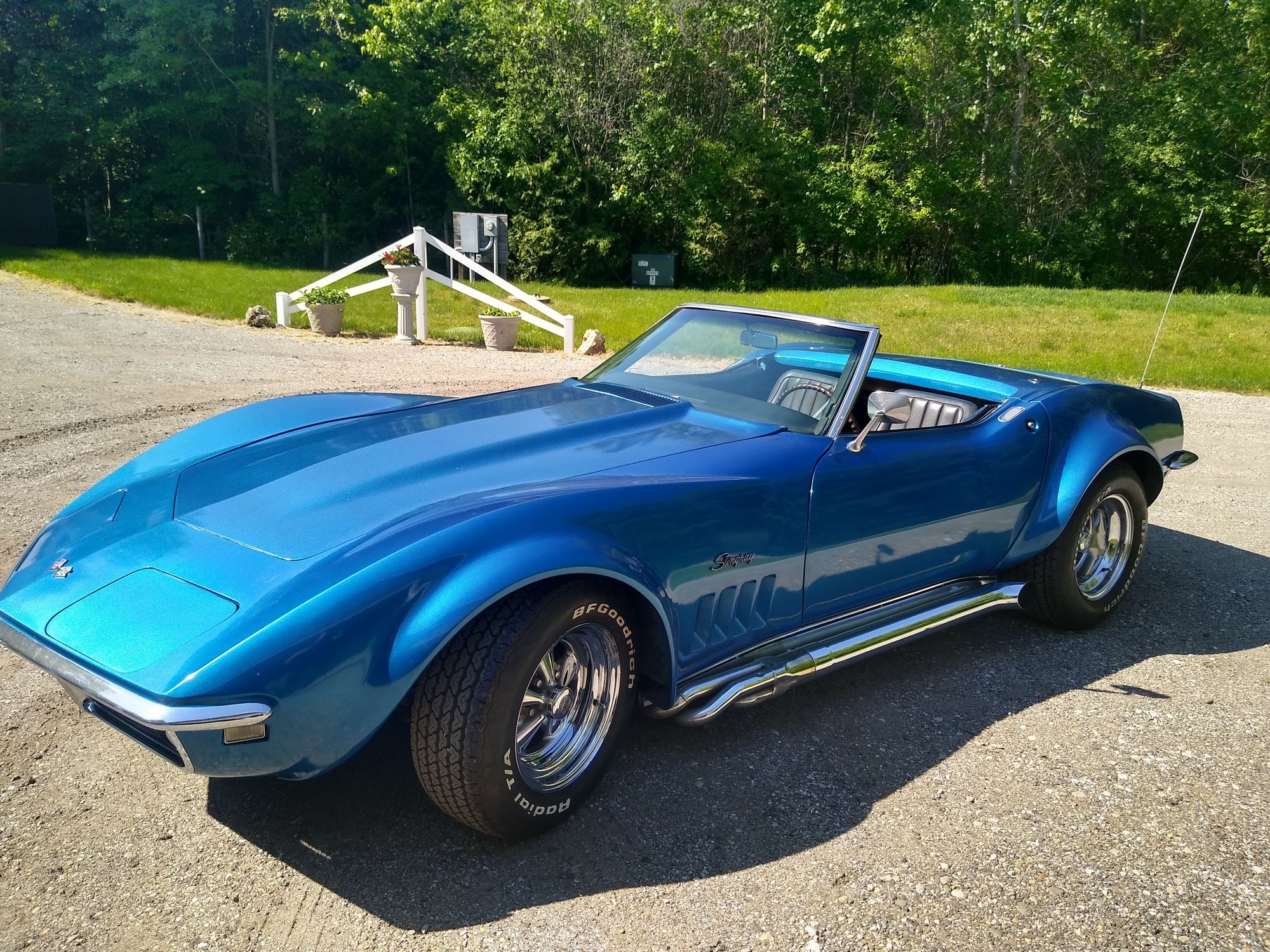

I dont know for sure what the hood is that is on it. I will try to attach a picture. I am having a new 383 stroker built for it and the builder said I will need at least an L88 size hood. I thought about my own scoop but really like the Baldwin and can't find it in just the scoop.

Hi Jose' and welcome to the forum. Nice vette.
I dont think there should be any issues with the hood at all on your car.
I think it has the same clearance as my stock 77 hood, which closes just fine over a BB with an Edelbrock rpm performer intake.
You should be fine.

Once the engine is done and in the car, take your measurements.
The long 73+ hood you currently have is about 1 1/2” taller than the 68-72 short hoods.
You can also install a drop base air filter that will give you even more clearance.
There are numerous threads where members have discussed choice of intakes, air cleaners and hood clearance.
You may be just fine without replacing the hood.

your car has an engine in it now, i assume? wad up some aluminum foil into a few ***** and place them on the air filter and close the hood. they will squish down to the gap you currently have between filter and hood. do you know what intake you currently have? and do you know what intake the 383 comes with? you can find the height of both intakes and compare to see if new one will fit and if not, how much you need to drop the air filter. and that is a 73-76 stock hood does it have the vac actuated ram air setup in it? if so, 73-75 hood. if not, 76 hood.
