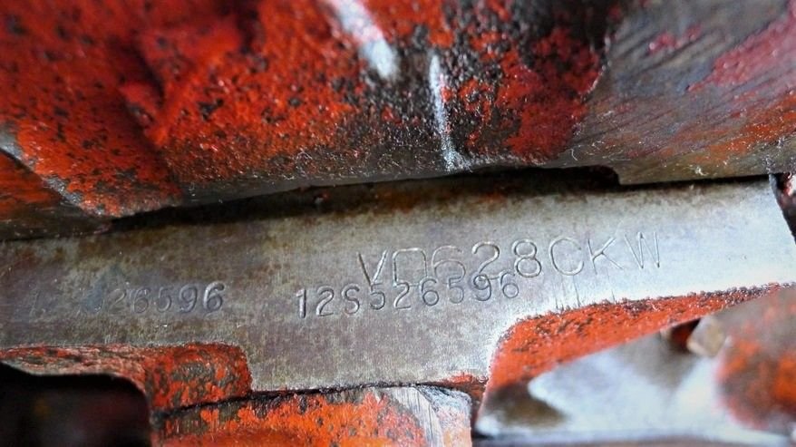

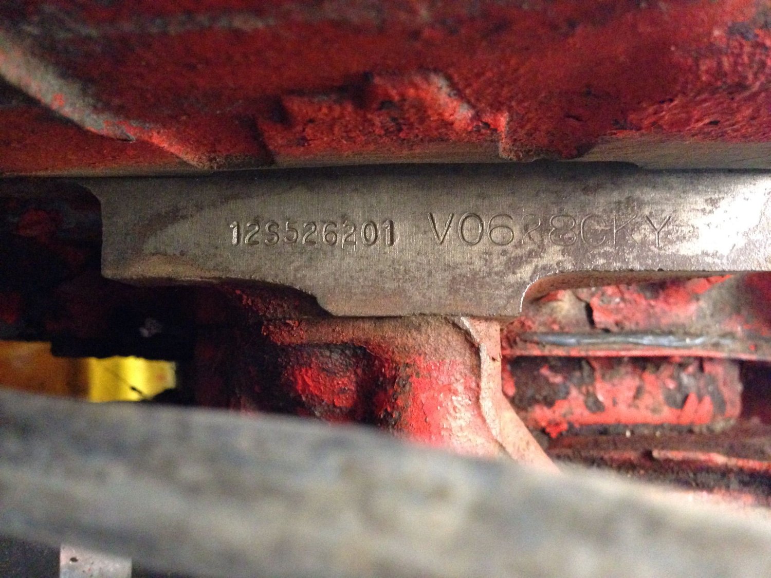

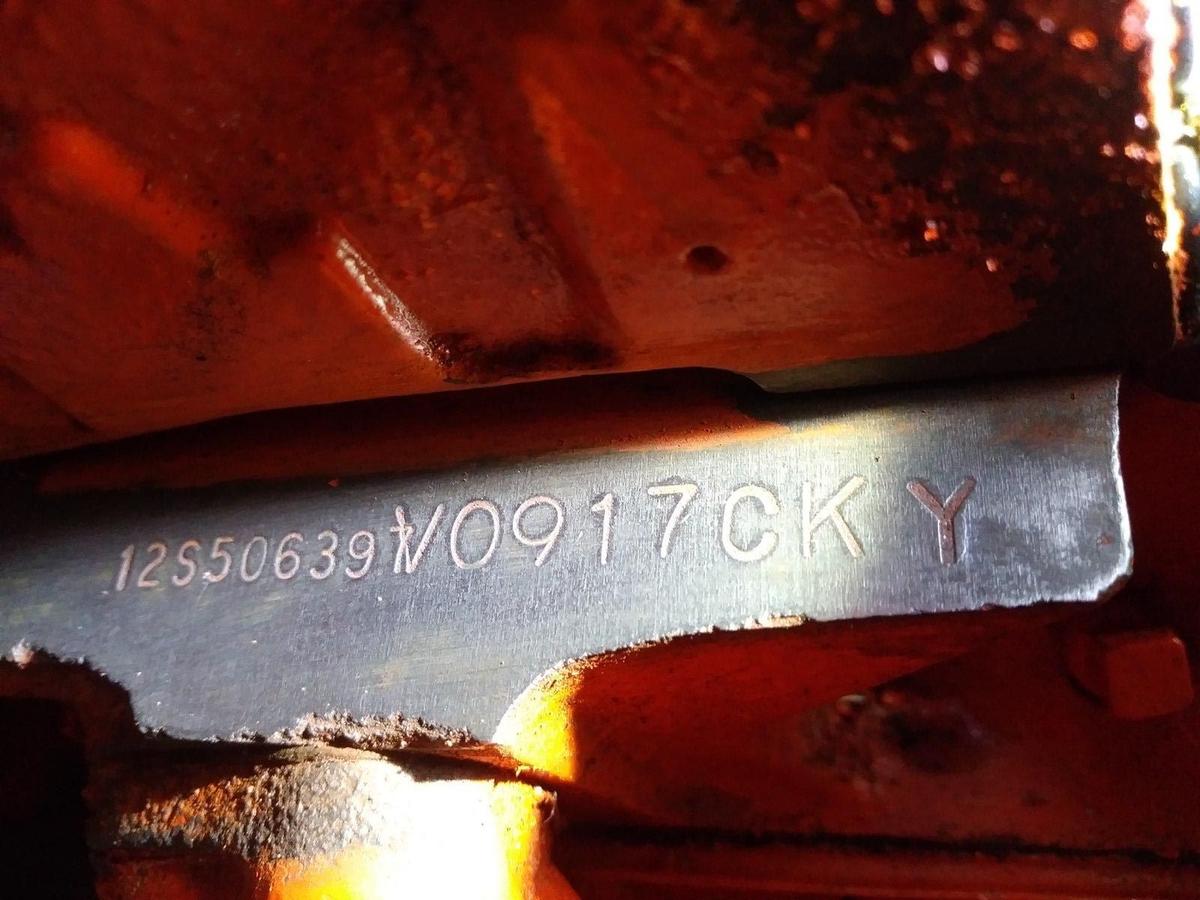

Here is an original stamp same day but different engine. The VIN looks right on a double stamp as the first one was not complete. They usually did a grind out but this time they did not and tried to re-stamp right below the Suffix. The "0" on the LT-1 is a different zero then yours but they had multiple stamping holders for each engine type. They would only change the dates Month and day.

Originally Posted by 67:72
Man, that is one solid VIN stamp. Musta grabbed the 10 pounder for that one.
What I really like between this VIN stamping and the double is the 12S526 are aligned alike. Same gang holder. Yes the Vin is a very deep stamping.
