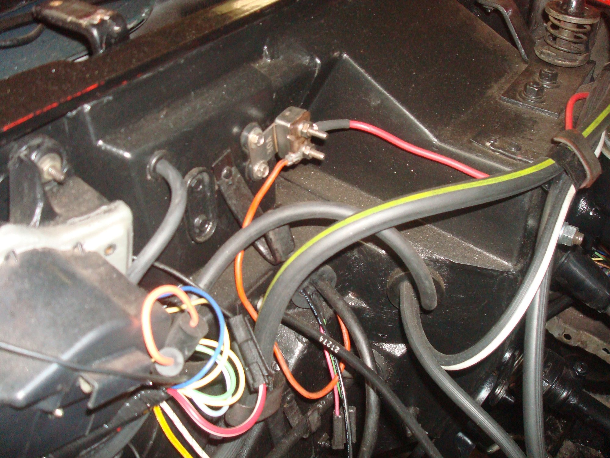

30 amp circuit breaker is on the firewall and the relay is under the driver side fender from what I see

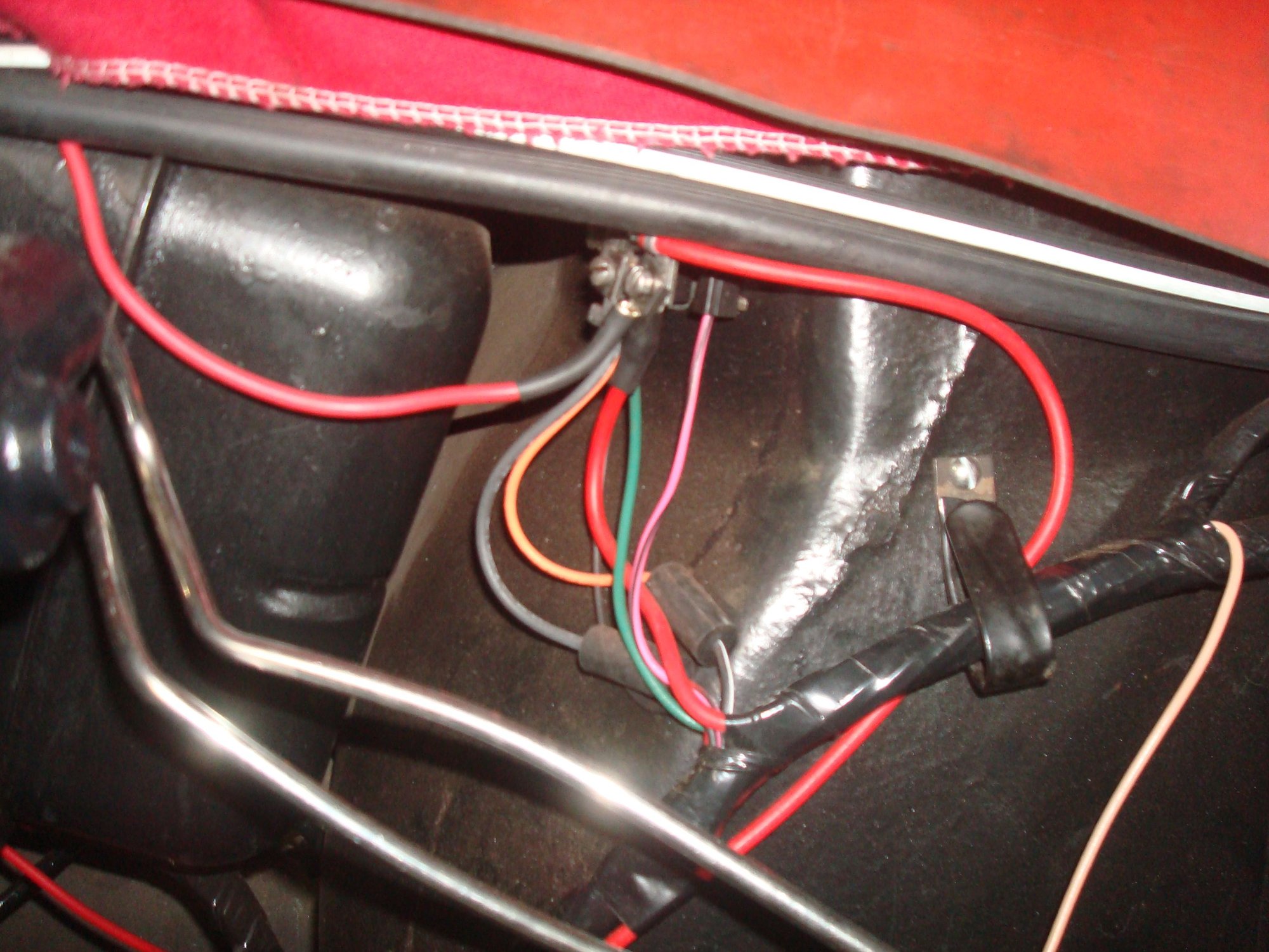

Hello sw69vette. Did some work on my 69 a while ago and cause a spark/short on the pw circuit. ended up replacing the circuit breaker and the relay. That is the relay that is at the front left side area of the shifter console. The relay can be reached by removing the side radio access panel that is on the drivers side at the front of the shifter console. Not the horn relay on the left fender ,#1picture, that is also wired to one side of the circuit breaker.
