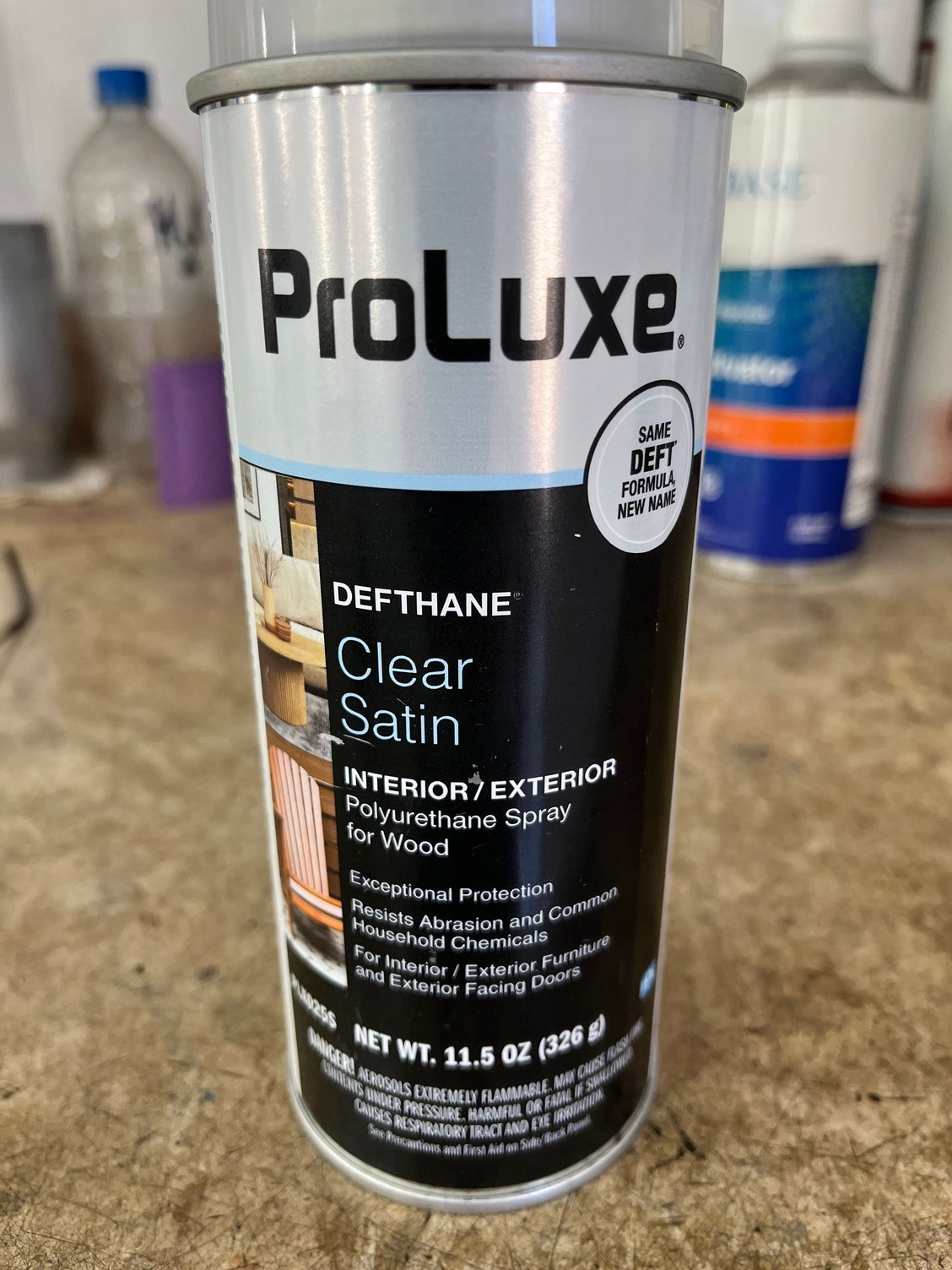

Since my interior dash panels were pretty much trashed as far as different dye colors, cracks and other broken stuff I decided to repair everything and do a repaint. The seats, door panels, and dash pad are all in good shape so I didn't do nothing with them. I plan on replacing all of it later on down the road, but wanted it to look good for now. I found a very close match of Rust Oleum spray paint and did a finish coat of clear. Used a satin polyurethane for the clear. Came out really nice and will work until the funds get built back up for a new interior.
