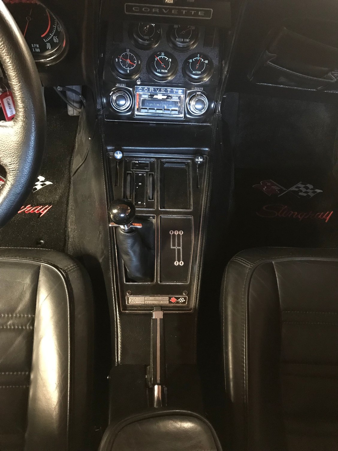

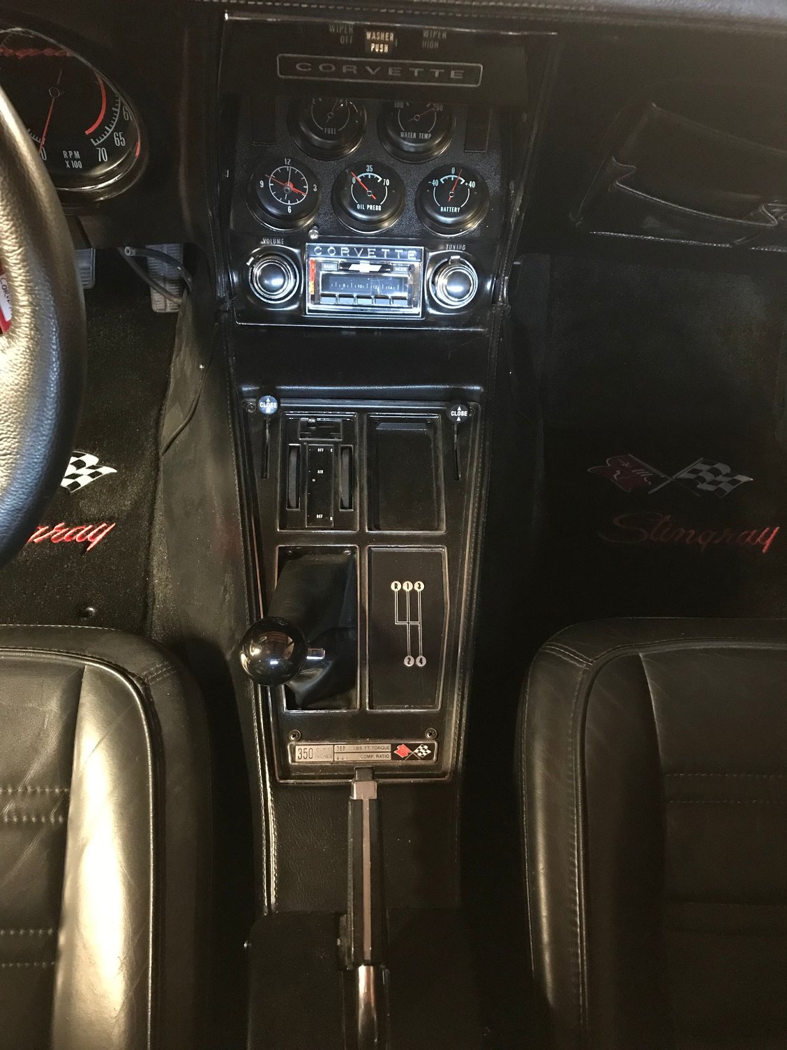

Here are pics of 2nd gear and 1st gear. As you can see, the shifter is tight against the left side of the console.

Cabman I might be wrong cause I can’t even see to matching socks out of the sock drawer, but from your picture it looks to me like the console might be somewhat off center. Just my .02

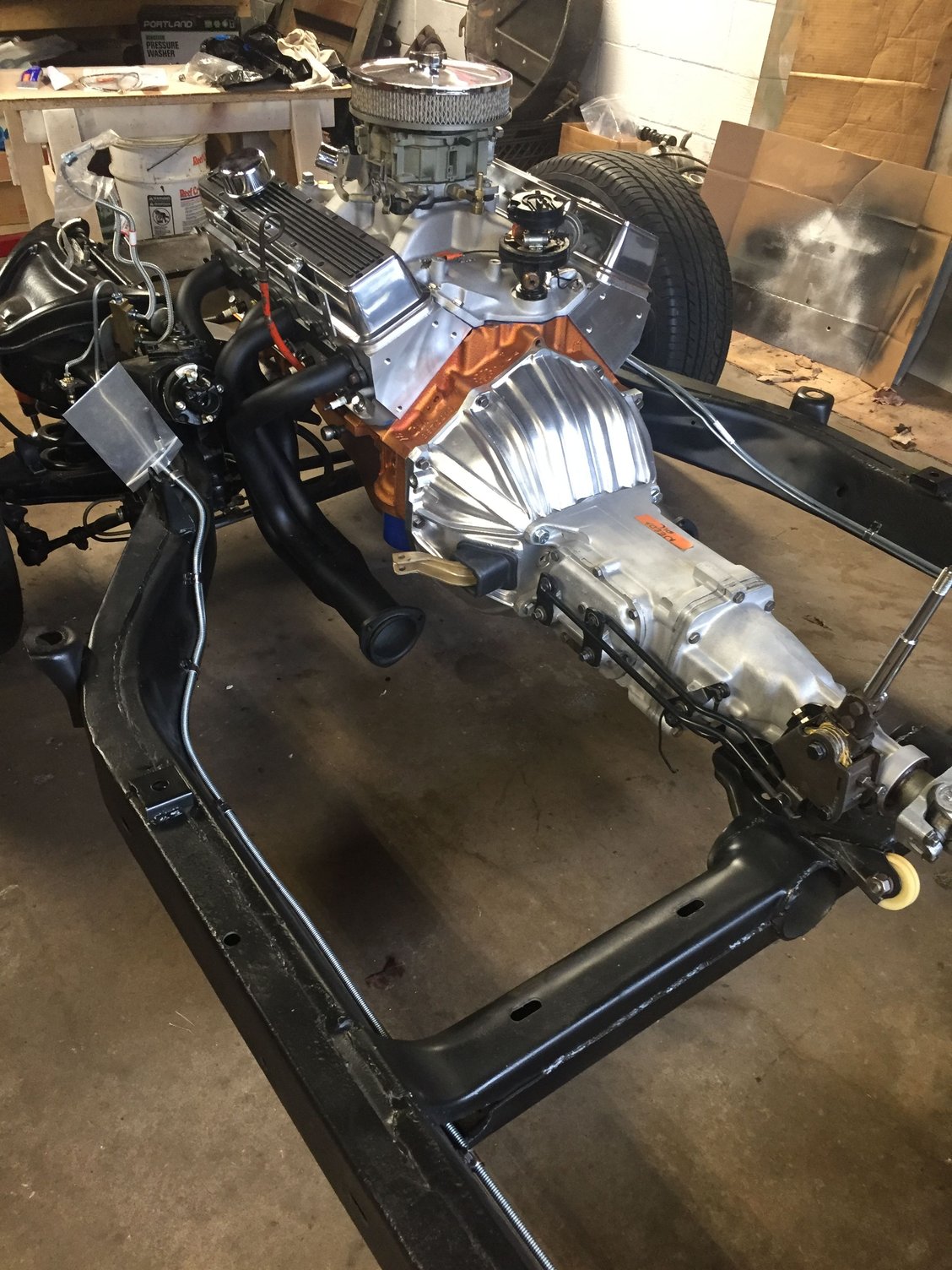

Ok, here are some before and after pics. Can you see where I went wrong?

Is that the Southern Car Parts stock appearance shift **** for Hurst shifters? Is the base offset, and could you turn it around? If not, perhaps you just need a shim (washer?) between the Competition Plus shift assembly, and the lever (at the two bolts, circled).
I failed to take pictures when I replaced my lower shift boot/bellows, but you may be able to do this from above.

I'm hoping I have the adjustment at the tail shaft like Rescue Rodgers mentioned. That would be by far the easiest fix. I'm pretty sure the shifter was reassembled correctly. It looks the same in both pics.
