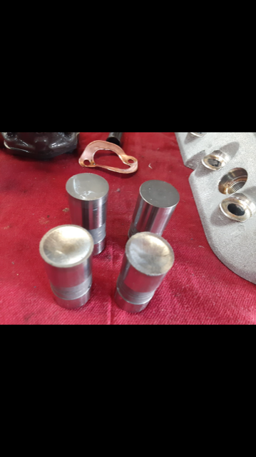

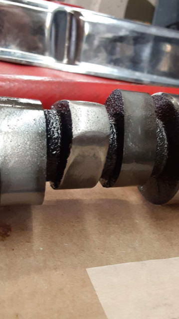

50 years of playing with SB Chevy engines and I have never had a wiped cam lobe on a new install, I also have never removed the inner springs.
THe oil changed in the last decade to eliminate so many of the specific lubricatioons that prevent that severe metal to metal contact during breaking, the phosphates and zincs, so you need break in oil heavy in those minerals and chemicals. More and more aluminum heads are coming with roller lifter cams that have a higher seat pressure and can contribute to wear prior to a proper breakin. THeres a lot of things you can do to prevent it. Ive swapped cams or built an engine every year for the last 5 years and never wiped a cam either. So if a shop wipes a cam that should have more experience than I do with building motors, get a new shop or they should rebuild you motor for free.

Roller will only help w/more power and pass smog. ZZ9 cam is popular and will pass for instance
Jebby mentioned lifters spinning freely...too many guys glop tons of stuff on their lifters well guess whats toughter to rotate?
I only use oil on lifters thats it. Ditto on comp lube its garbage.
Spot on IMO. Too many alternatives on the market when it comes to petroleum, oil and lubricants (POL) to not get this right. Jebby touched on a couple of those, my engine rebuild POL list is;

Break in the cam, replace the oil filter, top off with oil and drive car for 500 miles than change oil and filter.
I also have a start stand I built with radiator, fan and full gauges for engine break-in to head off any issues before installing engine in a car. Like Jebby I could never do this type work for a living because I'm too **** when it comes to details and it takes me 2-3 times longer to get anything done.

Use moly paste on the cam lobes….lifters go in with a shot of oil…..
I never use assembly lube either…..not on a V8 because I can prime it before start….motorcycle engines I use assembly lube on mains and rods.
I use the Lucas ZDDP additive 1/2 bottle and flavor of the week 15w40 diesel…..
Don’t forget the distilled water for your antifreeze.
